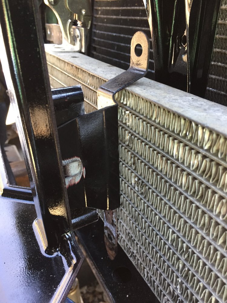

Not much to the Ranger today, but I wanted to at least get some paint on the new brackets. Ended up making most of the new center header panel support too...
What are you having to make? I thought that the parts were basically bolt-on aside from the wiring changes.
He needed a set of brackets made to support the transmission cooler he is adding. It's getting mounted to the front of the core support.
My new lights plug into the harness connector that the socket would plug into. Problem is, 98-03 use the same connector, but they changed the connector for 04-11 and the lights I got, even though listed as 01-11, have the 04-11 connector, not the older one. If the connector was the 98-03 style plug, it would plug right in to one of the two turn signal plugs. I was intending on doing that and just capping the other.
The brackets that got made are because of a self-inflicted problem. I got a transmission cooler from an 07 F-150 which stretches all the way across the front of the core support in front of the radiator. Had to make custom brackets to mount the cooler and then it was in the way of the center support bracket for the header panel. We kept the cooler low enough to get to the top bolt hole for the center bracket, but the cooler is where the rest of the bracket would go. So a little custom adjustments were needed. But this all nets me a trans cooler more than twice the size of the original and it’s got threaded fittings so there’s now no rubber lines for any of the transmission cooler stuff, it’s all 3/8” aluminum hard line and -6 AN PTFE.

When it comes time to do a V8 swap I'll probaly add more transmission cooling, but I was going to go dual cooler rather than larger cooler. I've got a couple of spare stock transmission coolers and the single stock cooler would probably be more than enough for my needs, so I think two of them will do fine.
Got it (y)
Yeah, we did two of them in dad’s V-8 Ranger. I had got a second stock one intending to just do two stock ones and was in the junkyard the one day and right next to the Ranger section was this 07 F-150 that the front end was tore apart and I see this cooler and went over, gave it a good look, couple measurements, go over to a Ranger and do some measuring and go, well that might be pretty sweet. So, here we are, lol
