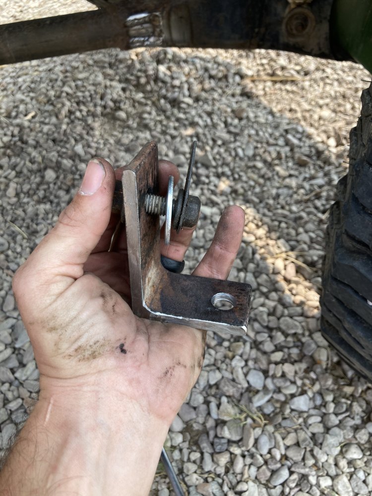

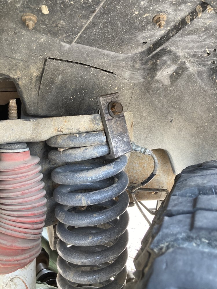

Nope, when I replaced the coil buckets on my 95, I bought new spring retainers. Then I realized they fit about perfect on my choptop springs and all I had to do was drill a hole like the 150 coil buckets had from the factory so that’s what happened. I dunno if I’m really going to do much today, but if I think about it and make my way down to the choptop I’ll see about a pic or two

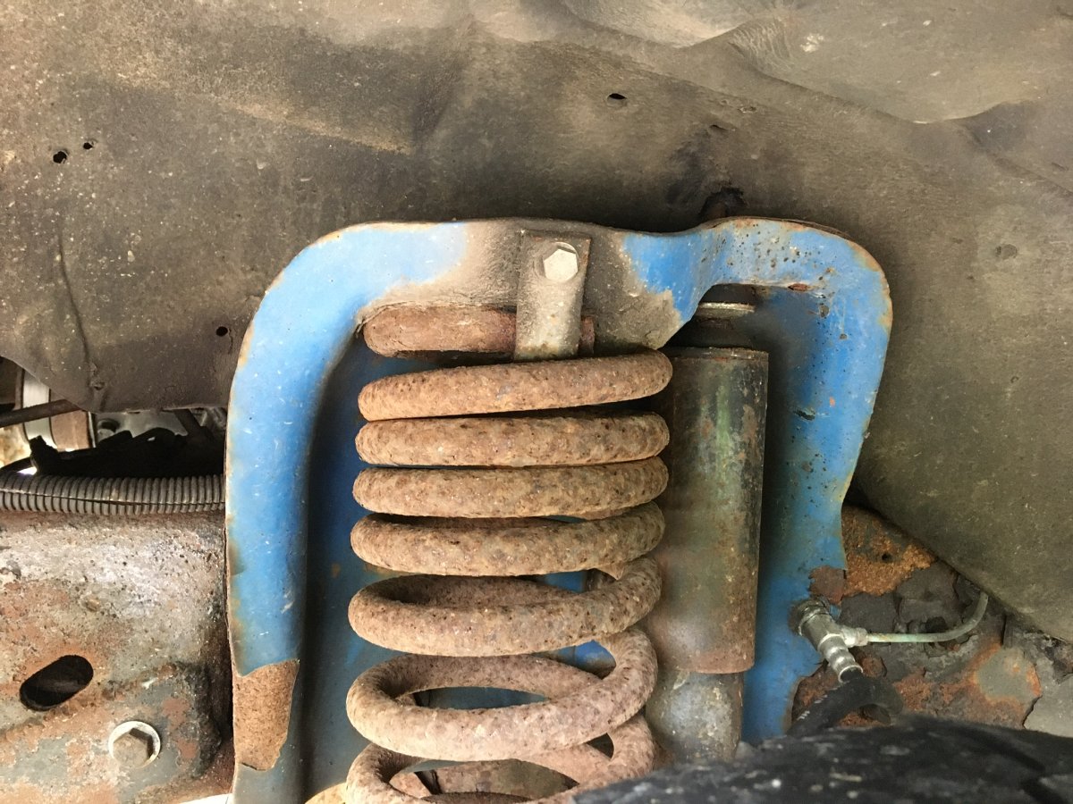

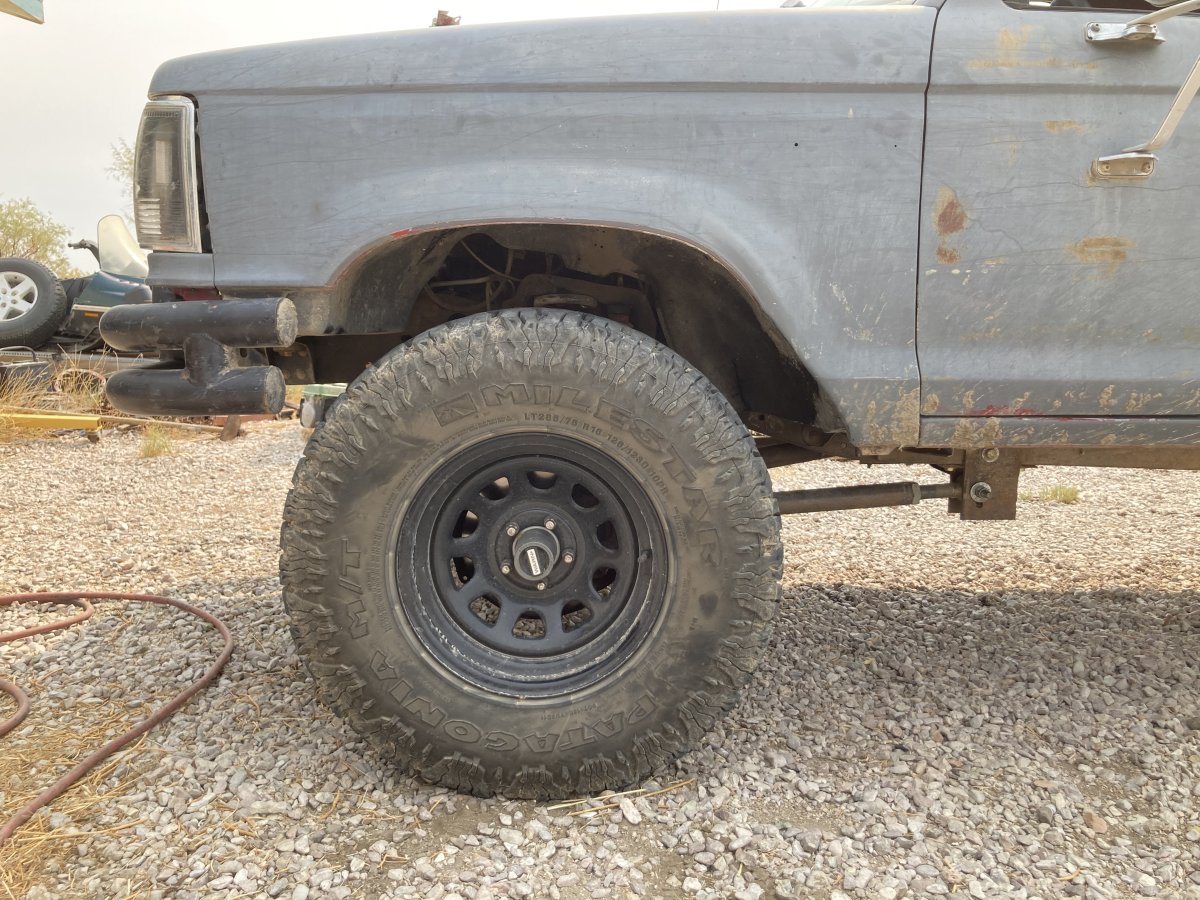

1995 F-150 (note there is a little difference in the design, the top coil tucks in, the retainer actually fits in a notch on the inside, but it’s still like a 3/16” thick tab)

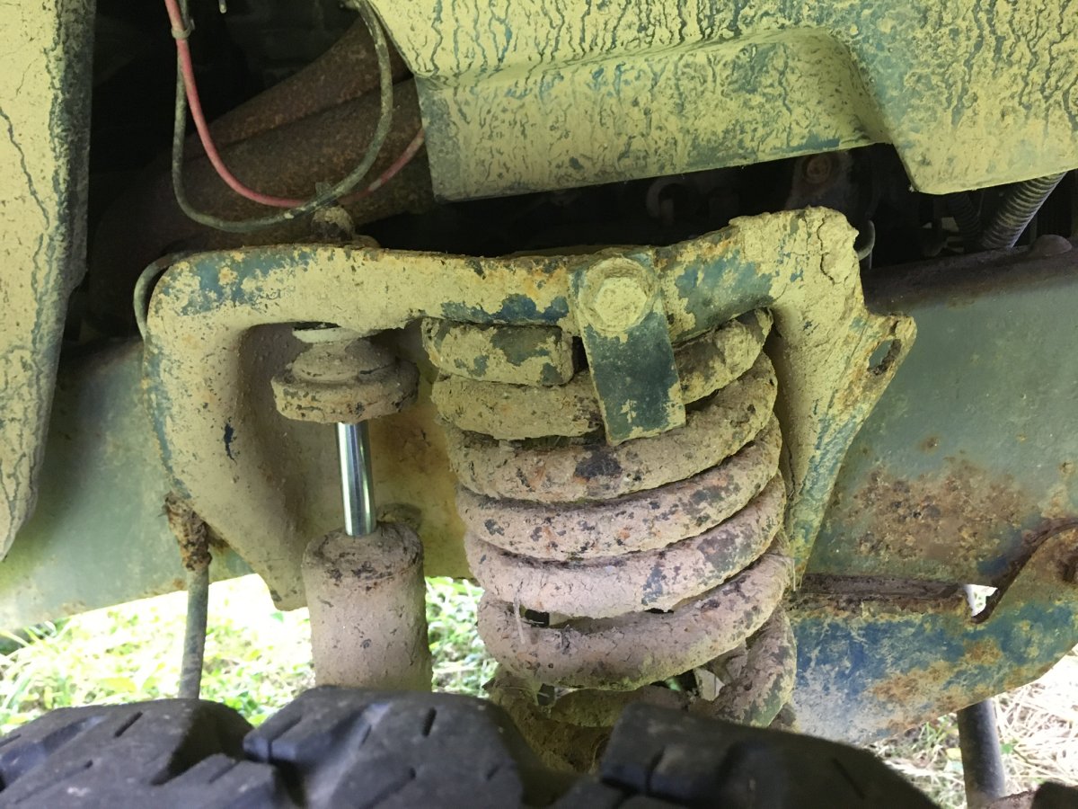

1989 Bronco II (ok so I probably should have took a drivers side picture) That coil is a James Duff 3” lift coil, but the tab fit just fine and has held up just fine thus far
I see, I didn’t think they had a tab. I assumed that they would have the little bent over tabs like the RBV’s
I’ve always had to add my own.
I've found that if the truck never leaves the driveway... there really is no need for coil spring retainers.
I'm seriously going to have to look at my Bronco II... I don't think I've seen spring retainers on it.
I didn’t think it was really going to be a problem until one popped out. The little tabs seem to be fine for street use and even stock suspension. As soon as it’s modified and you head off road though…
