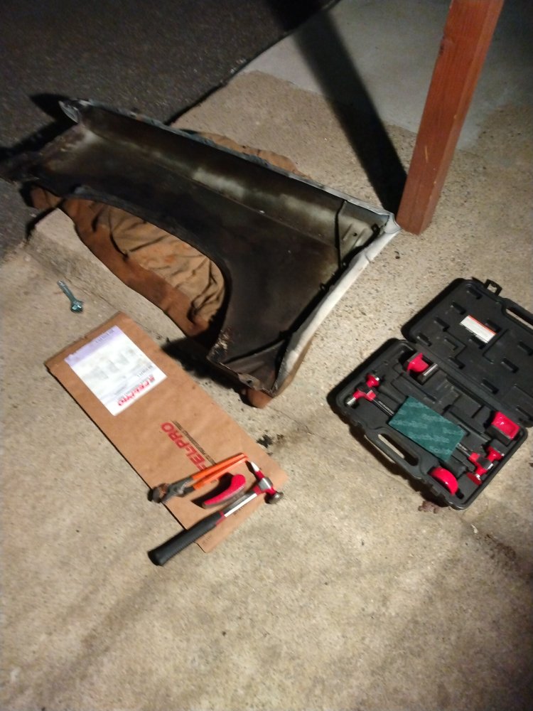

Been driving the bronco entirely too fast through the woods and doing sweet jumps. Hit/landed on something particularly nasty and it pushed the wheel into the fender and crunched it. Just hammered it back straight tonight.
I was just rushing to get it done so no before image. The metal is a little streched inside the fender, but the outside profile is correct. Now I need to find out why I have positive camber on one side and negative on the other...
View attachment 81851 View attachment 81852
You probably bent something.

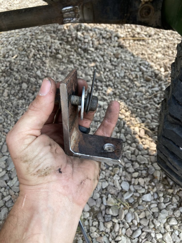

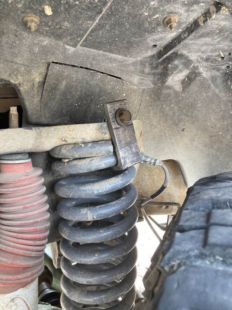

Trimmed the fenders and made upper coil retainers. The coil retainers were easier than I anticipated. Some 1/4” thick 2.5x3.5” angle iron with over sized washers to clamp the coil to the coil bucket without having to drill holes in the coil buckets.
