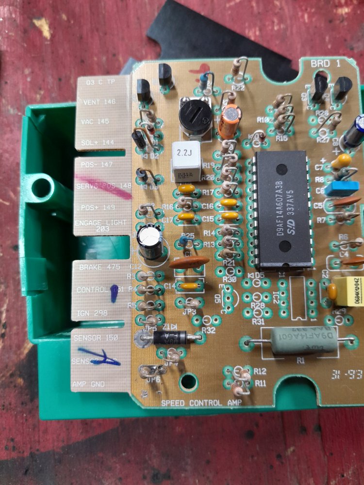

FINALLY....fixed my Cruise Control....
I've been chasing a cure for a few months now, but by using my new tool (the EVTM) I was able to better trace the issue to the Amplifier.
In my recent visits to the pull yard, the amplifier was one of the items I was able to snatch along with the steering wheel mounted cruise control buttons.
I popped in the amplifier and lo and behold, it worked.

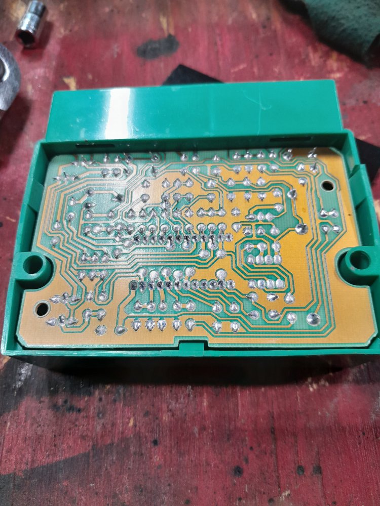

Checking for continuity on the printed circuit side, I found a couple of opens. I'm assuming those were the issues.
Now I can cruise.
what was open? bad solder joints?
Tiny cracks in the print. Plastic was really brittle. Can't see the cracks with naked eye. Prolly could've tried to solder them, but frankly, I'm tired of messin' with this problem. I'll keep this one just in case the working one craps out.
