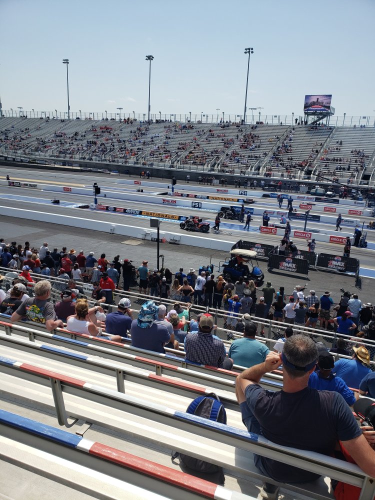

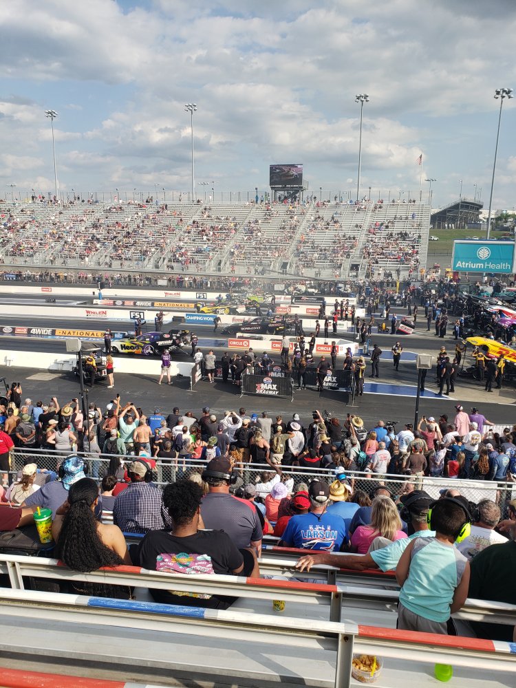

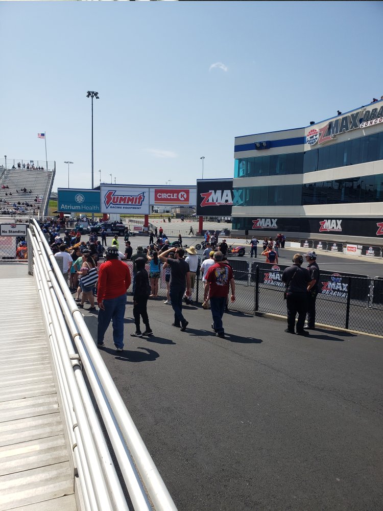

Nothing to the ranger other than drive it here. Was my first time seeing the 4 wides tho. And I must say I'm highly impressed. I tried to upload a small video of 4 wide launch. But it wouldn't take

That looks awesome to watch. I have never heard of four wide

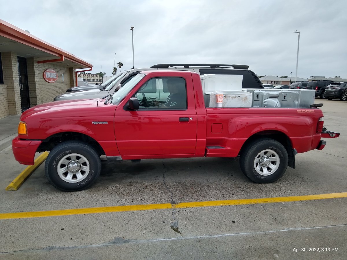

The ranger killed it another Friday night and Saturday. Drove to kingsville with the other cars but they were going to fast, I was bouncing off the governor so I need to take that off somehow. 92 almost got me in trouble at one turn because I couldn't go faster to get out of the way.
And then after all the bike event stuff Saturday morning, I got a super deal on a front load washer and dryer combo, 200 bucks. So we ran to the island and loaded them up. I did not know front loader washers are almost three man lifts though and make the truck squat down. But having all that weight in the back made it ride like a Cadillac

superj; Most front loaders have a big mass dampener-the one on mine is concrete…..
