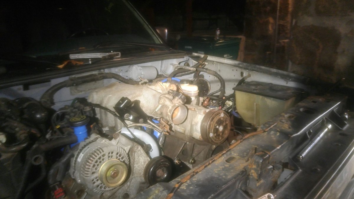

Well that's not the right intake to be under the hood of a Bronco II...

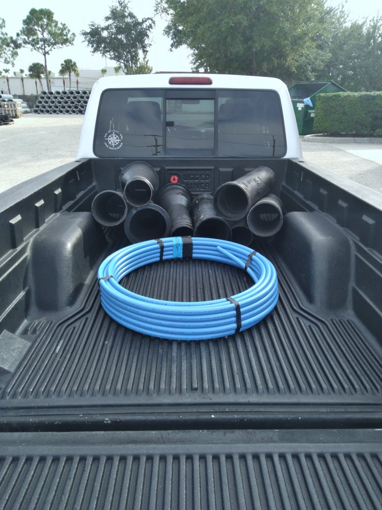

Got some plumbing supplies with it.

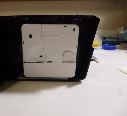

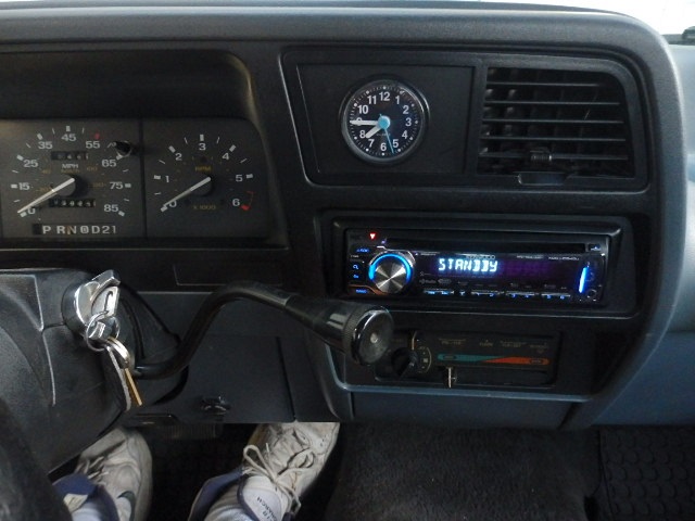

"Project Dashboard Clock" w/Sweep Second Hand - Fun Project !
Got tired of the phony vent in the center after 13 yrs & made the space useful by adding a clock. Came out pretty good.
The vents pop out pretty easy with a plastic spudging tool & a small screwdriver.

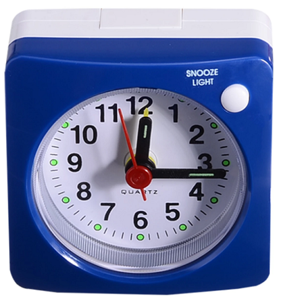

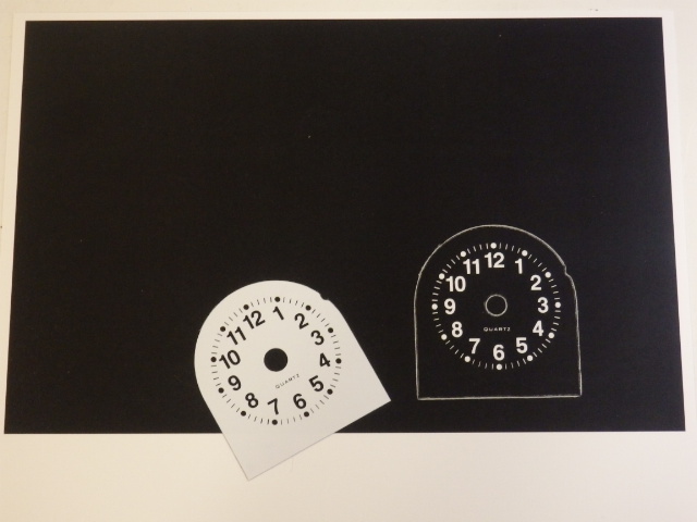

I bought a $3 travel alarm clock & took it apart to remove the snooze/light button & bulb. Also the alarm hand. Removed the white dial from the movement &
took it to a FedEx printing center to print the dial inverted (45¢ a copy). First I had to blacken the green dots on the dial with a fine point Sharpie & trace the edge
& center hole on an index card so they would come out white. I also had to paint the hands.

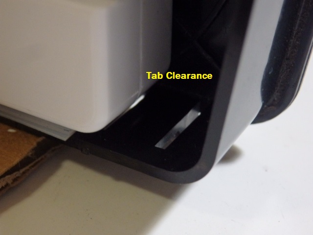

I didn't use the front trim of the clock. Instead, using a piece of scrap plastic I cut a plate using the fake vent as a template. Then I cut a hole in the plate for the clock window.
The movement mounted well with 3M mounting tape & some scrap plastic & epoxy to raise the movement so the dial would be centered up & down.
The front of the dial & movement butts up with the back of the clock window which I pressed through from the back of the plate. I went to my local hardware store &
picked up an O ring to use for trim around the clock window.
Right now its running on a AA battery & thats ok but I have a DC buck step down converter on the way & I'll give that a try so the truck can power the clock.
I also have some 12v 3mm blue LEDs on the way & I'll put 1 in & tie in to the dash light circuit. If it's too bright I'll figure something out, maybe a different resistor.
I'm not sure if the LEDs I'm getting are dimmable with the light circuit but I really never dim the gauge lights anyway.
I can't adjust the time from the front of course, but it's a quartz movement & as I mentioned the vent panel comes out fairly easy.
As for replacing the battery, let's hope the converter works out ok.
I have some improvements in mind but this will do for now. I wish I took more pics but I was too busy having fun with this !
Cheers !! View attachment 67205

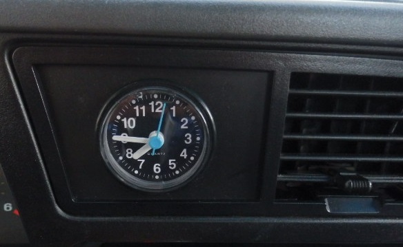

"Project Dashboard Clock" Finished !!
I got the buck converter in along with 2 LEDs @ 12 & 6 o'clock. Clock runs very well & keeps good time. LEDs dim with the headlight switch (Tied into Instrument Panel Illumination circuit).
To run the wire I straightened a coat hanger & poked it through the hole for the FWD switch harness end (Battery disconnected, of course) toward the left toward the steering column & then
worked the end to the fuse box. No restrictions ! I Attached the wire to the coat hanger then pulled the wire up to the hole.

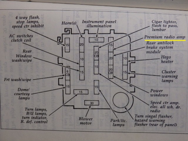

For powering the buck converter/clock movement I used a piggy-back fuse holder with a 1 amp fuse for it along with the 15 amp on the Premium Radio Amp circuit.
I guess back in the day you could order a premium stereo package (
) & that's what the circuit is for, but it is 12v constant.
I mounted the converter to the left of the square hole where the FWD switch harness end stuck out. I used the ground wire on the harness for both circuits.
The harness seems pretty secure where it is so I covered the end & tucked it back in the hole just a little.

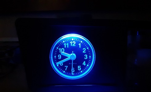

This is about how the clock looks illuminated with 2 LEDs (In the photo only 1 lit LED @ 12 o'clock. My lousy phone camera lets in too much light).
Looks a lot better in person. I'm pleased. CHEERS !!

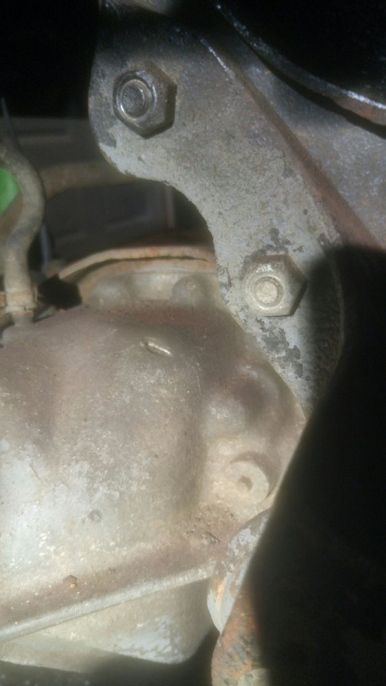

Well I didn't even realize it until yesterday, but the Rough Country lift poked a hole in my front diff.
I did not know they could damage the smaller d28 pumpkin. I will be changing out the RC lift (installed by P/O) for a better one once I swap in the d35.

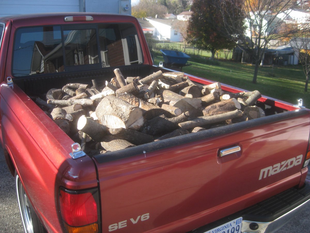

Can't do this with a Saab. Free firewood. Comes from across the street, but how hard would that be to move without the truck. Probably only impressive to me since I never had a pickup.
Trucks are great to have. Think how many times you would have crossed the street pushing a wheelbarrow to move that wood.
