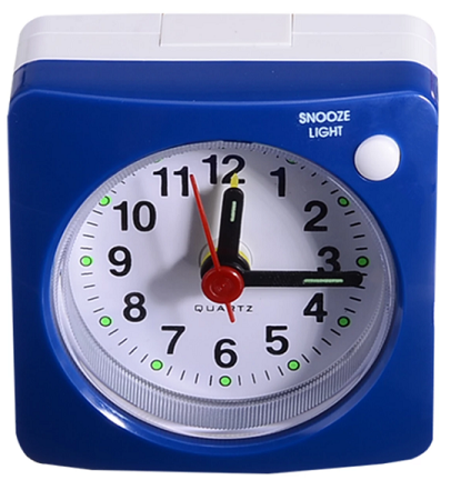

"Project Dashboard Clock" w/Sweep Second Hand - Fun Project !

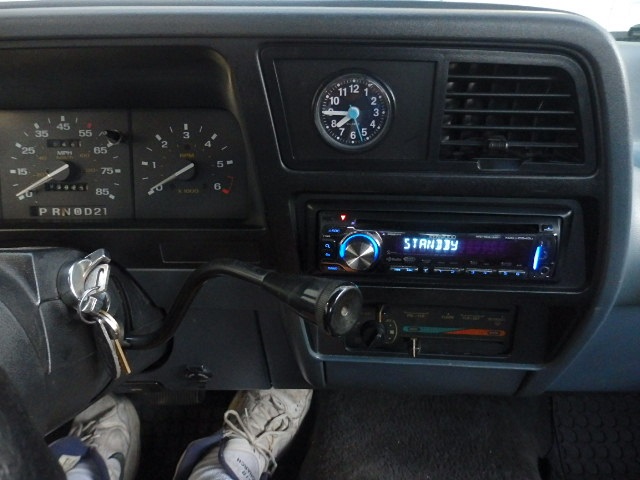

Got tired of the phony vent in the center after 13 yrs & made the space useful by adding a clock. Came out pretty good.
The vents pop out pretty easy with a plastic spudging tool & a small screwdriver.

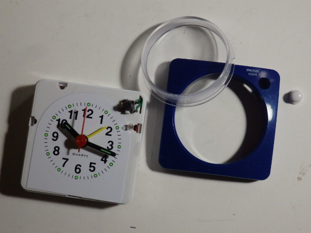

I bought a $3 travel alarm clock & took it apart to remove the snooze/light button & bulb. Also the alarm hand. Removed the white dial from the movement &

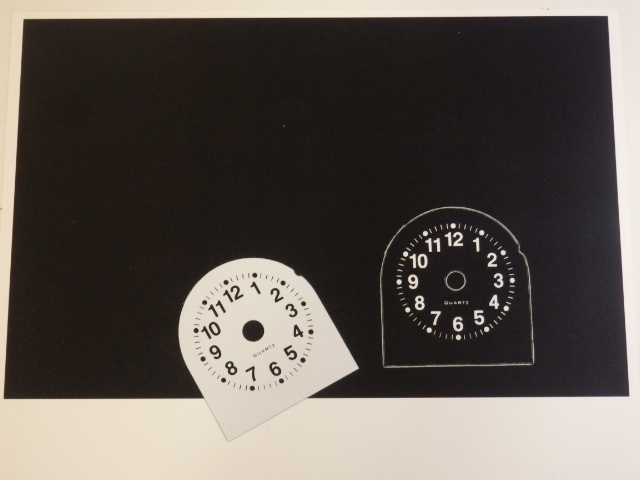

took it to a FedEx printing center to print the dial inverted (45¢ a copy). First I had to blacken the green dots on the dial with a fine point Sharpie & trace the edge
& center hole on an index card so they would come out white. I also had to paint the hands.

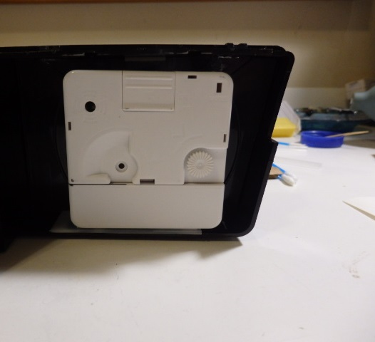

I didn't use the front trim of the clock. Instead, using a piece of scrap plastic I cut a plate using the fake vent as a template. Then I cut a hole in the plate for the clock window.

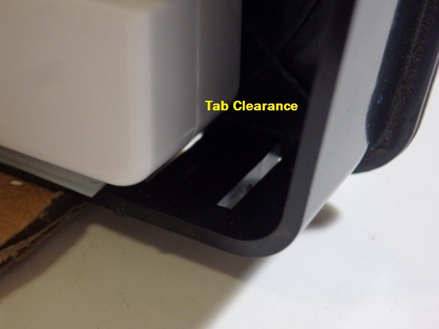

The movement mounted well with 3M mounting tape & some scrap plastic & epoxy to raise the movement so the dial would be centered up & down.
The front of the dial & movement butts up with the back of the clock window which I pressed through from the back of the plate. I went to my local hardware store &

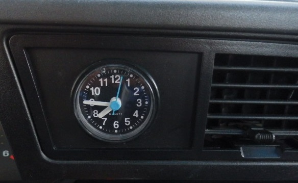

picked up an O ring to use for trim around the clock window.
Right now its running on a AA battery & thats ok but I have a DC buck step down converter on the way & I'll give that a try so the truck can power the clock.
I also have some 12v 3mm blue LEDs on the way & I'll put 1 in & tie in to the dash light circuit. If it's too bright I'll figure something out, maybe a different resistor.
I'm not sure if the LEDs I'm getting are dimmable with the light circuit but I really never dim the gauge lights anyway.
I can't adjust the time from the front of course, but it's a quartz movement & as I mentioned the vent panel comes out fairly easy.
As for replacing the battery, let's hope the converter works out ok.
I have some improvements in mind but this will do for now. I wish I took more pics but I was too busy having fun with this !
Cheers !!
i like analog clocks in vehicles. to me, it looks better than the digital ones on the radio or other places they put them now days
they just look higher class.
kids aren't even taught to read analog in school anymore. like cursive, the schools feel its useless, i guess. had to show my kids how to read analog clocks, write in cursive, and use an analog meter on the cars/trucks
