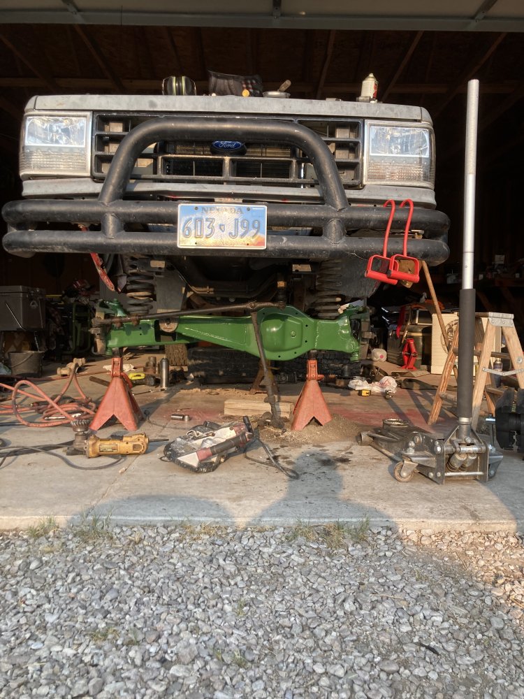

From yesterday:

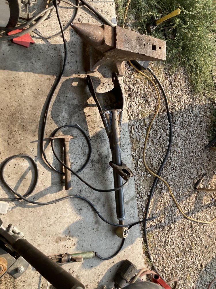

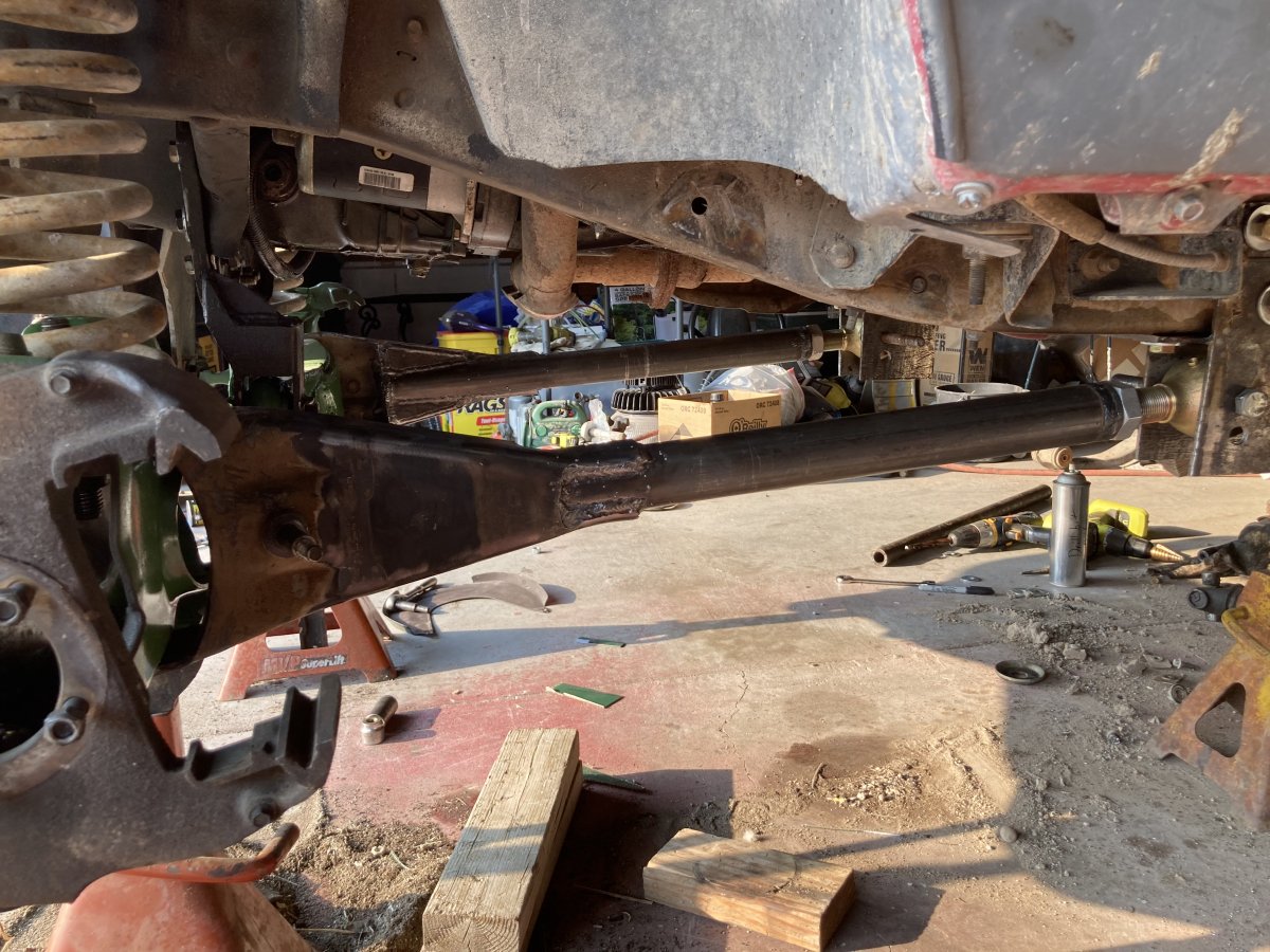

Finished extending the RA’s and installed them. I used 24” long 2”x .25 wall DOM with .25” plate to box them in. They’re extended to the trans crossmember.
Don’t mind my pigsty, I was trying to hurry and didn’t care. I wanted to get the beams installed because I’m headed to work today and won’t be home for 3 weeks.

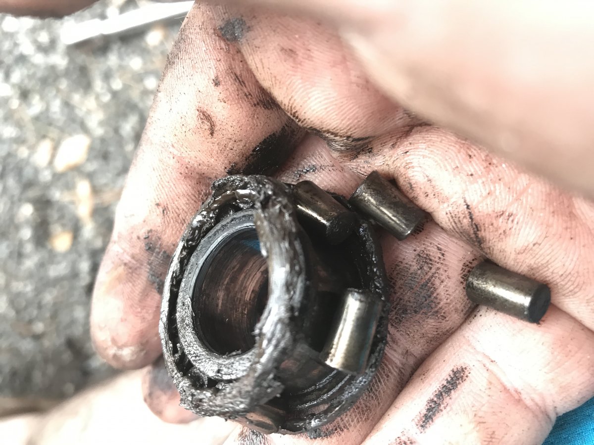

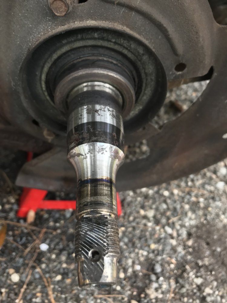

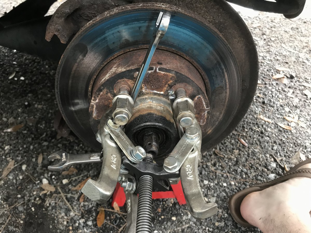

I did front brakes and wheel bearings. Glad I didn’t plan on repacking the old ones. Had to use my modified puller tool to get the old disc off. The spindle, or whatever it’s called, feels fine but I guess we’ll see.

Wow... Looks like it was over torqued or under greased or both.
At least you cought it before it destroyed the spindle completely.
Personally, I would heavily consider a new spindle. Where the outer bearing sits, there is evidence of a lot of heat. It also looks like the bearing race may have spun on the spindle and messed up the surface finish.
+1 on this. That spindle is going to be nothing but trouble if it’s let go.
I did front brakes and wheel bearings. Glad I didn’t plan on repacking the old ones. Had to use my modified puller tool to get the old disc off. The spindle, or whatever it’s called, feels fine but I guess we’ll see.View attachment 64223View attachment 64224View attachment 64225
I saw no mention of replacing the rotors. I hope you plan on changing them as well as the spindle that’s messed up. I know it’s more cost but with what happened to the bearings, the rotor and spindle are going to be damaged.
Thanks all. I didn’t feel any ridges on the spindle but it looks like it’s on the list now. I put in new bearings, rotors, calipers, and pads. I didn’t trust anything down there. I only replaced the right shock cause the left shock mounting bolt sheared off. Pretty sure it’ll need a new control arm. I’ll probably do all the suspension related bushings as well.
I dunno, it does look like it got cooked and maybe spun the race but the spindles can take a crap ton of heat without harm. If the new inner races still fit snug I'd be inclined to let it ride. If the races are loose, have any gaps, or don't fit right in the slightest then yea I'd chuck that spindle in the trash...
