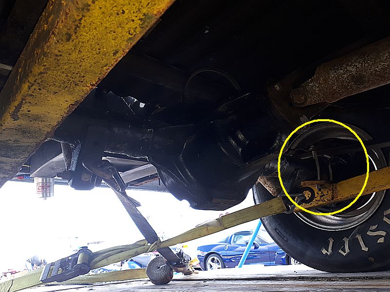

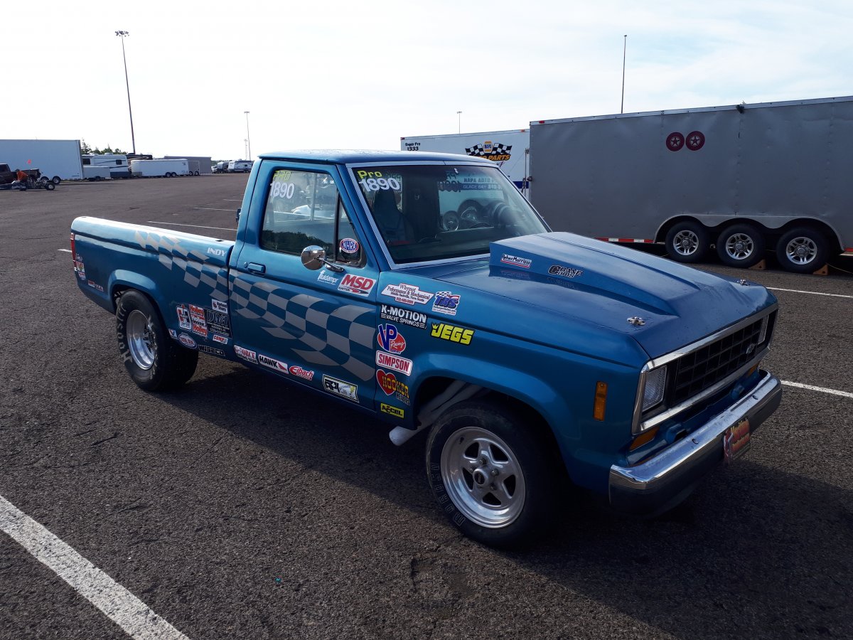

Water in the fuel cell, broken crank trigger, bent and broken rearend to leaf spring bolts and only one full pass all weekend but still got deep enough in the 7s that we're going to need a roll bar now. Could not be any happier with the new combination....

Traction bar bolts didn't get along very well with the new transbrake. No markings on the heads so they were obviously the lowest quality(cheapest) bolts the previous owner used to bolt it all together. Local Industrial Supply store gets a visit in the AM for some new ½" X 7" fine thread grade 8s with nylock nuts.

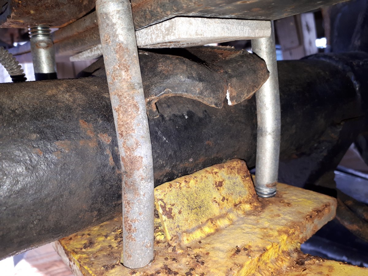

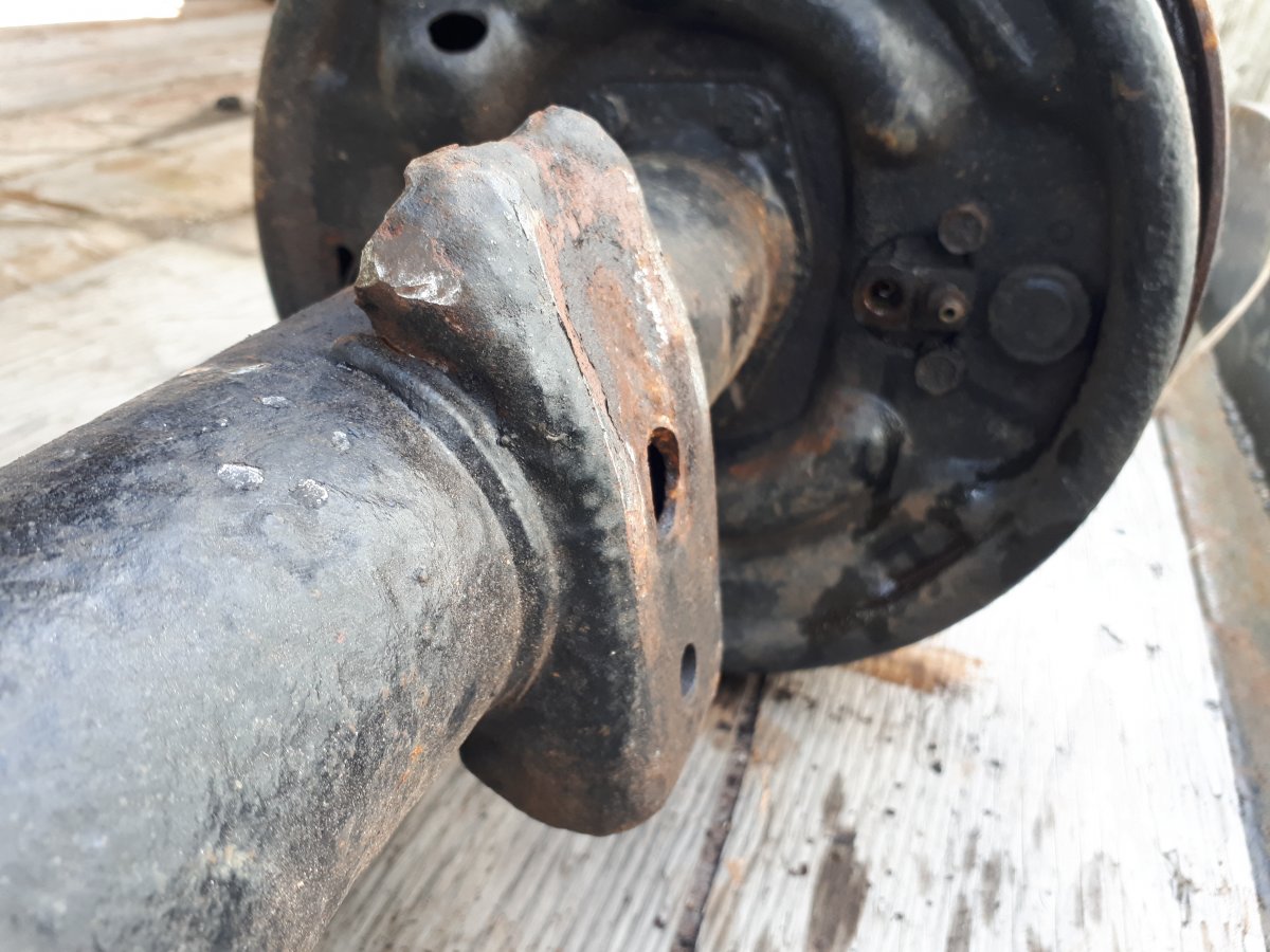

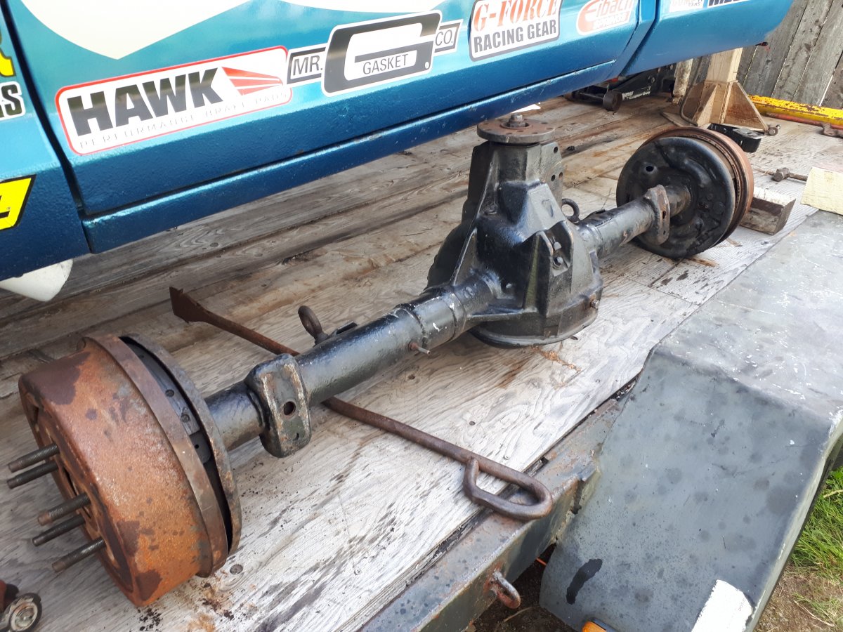

Damage was a little more extensive that we first thought.
