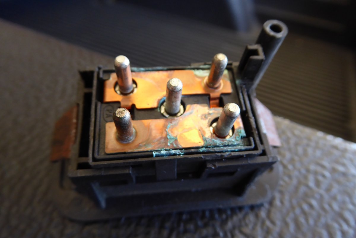

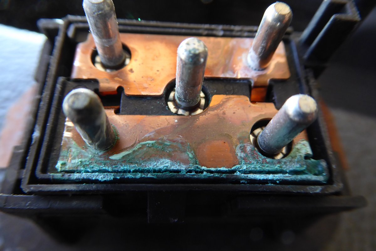

I tinted my side windows today with 35% since Summer has arrived early. While the door panels were off I checked to see why the window operation and door locks on both sides were slow and intermittent. Looks like the PO must have left the windows down in a rain and the pins were corroded. Used contact cleaner and a brass brush, lubed the sliding tracks with silicon and the windows and locks are perfect now.
