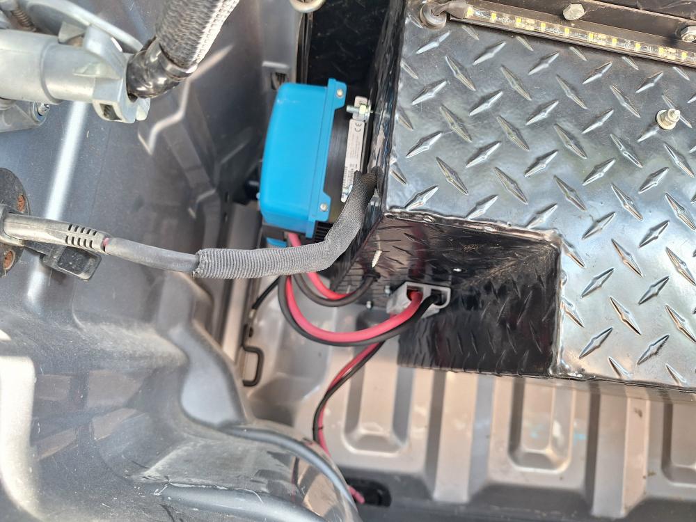

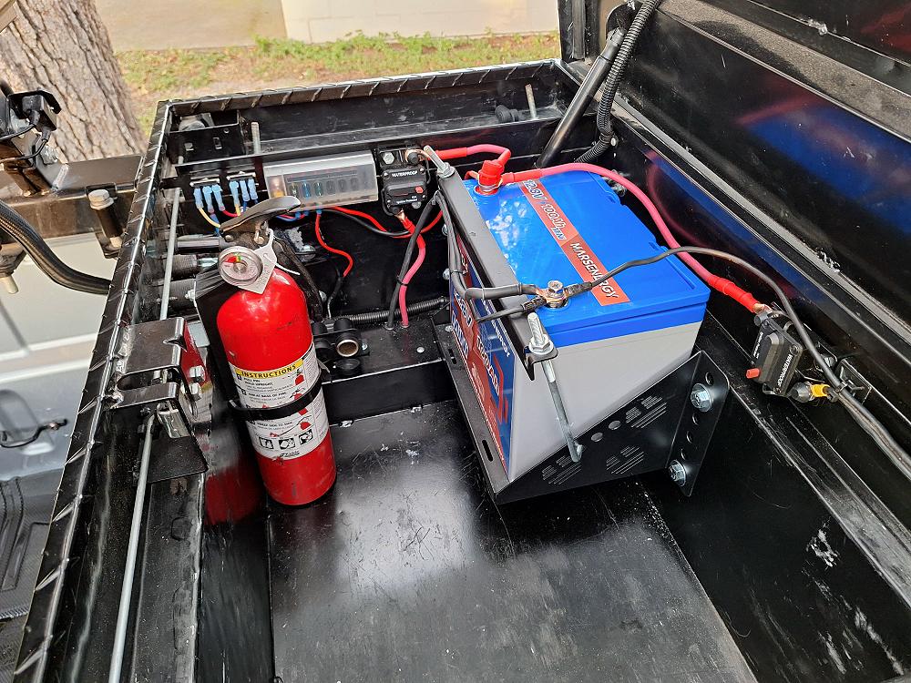

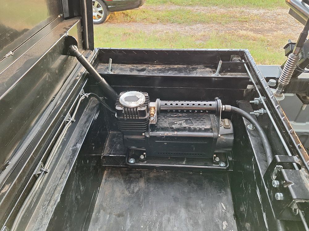

I added a Victron DC to DC charger and a Lithium battery to my trucks toolbox to power the outlets on the front of my toolbox so my fridge can run off of that at night instead of my main battery. I also hard mounted my Smittybilt air compressor and connected it to the battery, so I have air on demand now without having to carry it to the front of the vehicle and hook it up.

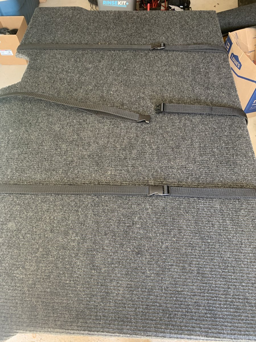

I made seatbelts for the back seat platform. They’re heavy duty webbing material, but the quick connectors I used are kind cheap and weak feeling. I’ll have to find different ones and replace them.

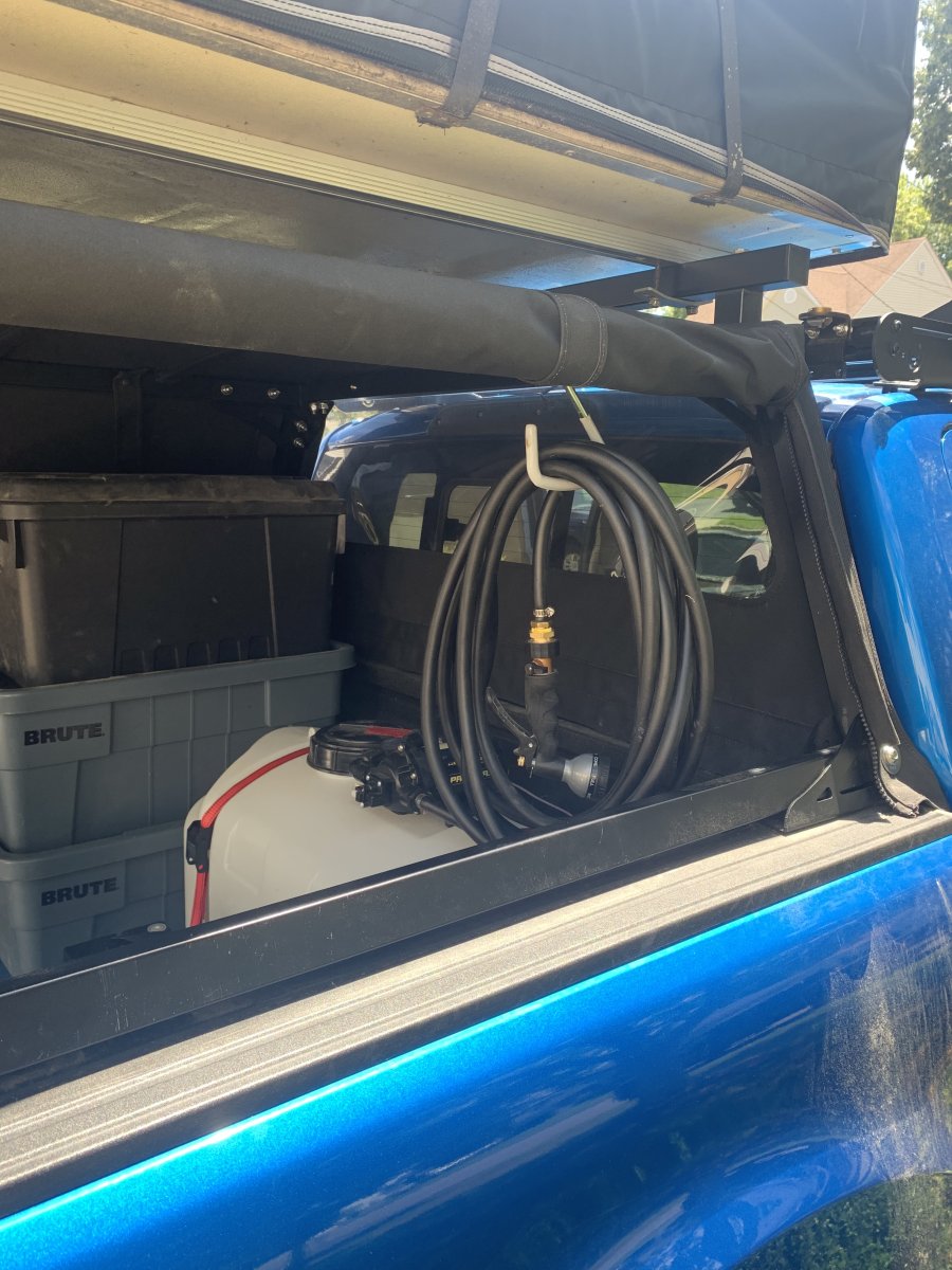

I “adjusted” the angle of a universal Lowes garage hanger to hold the hose for my spray water system. (It surprisingly took a good amount of effort to bend this thing.)

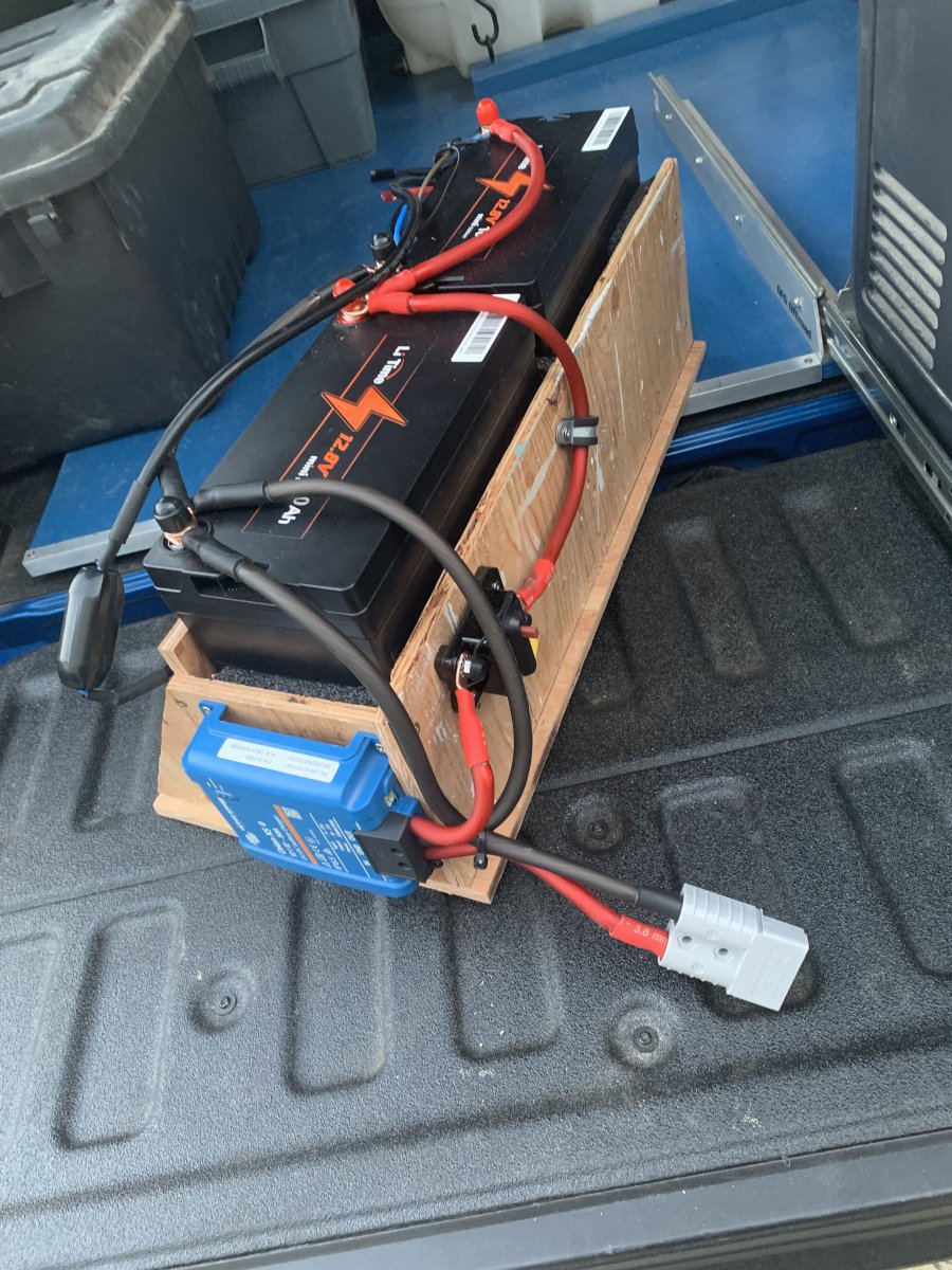

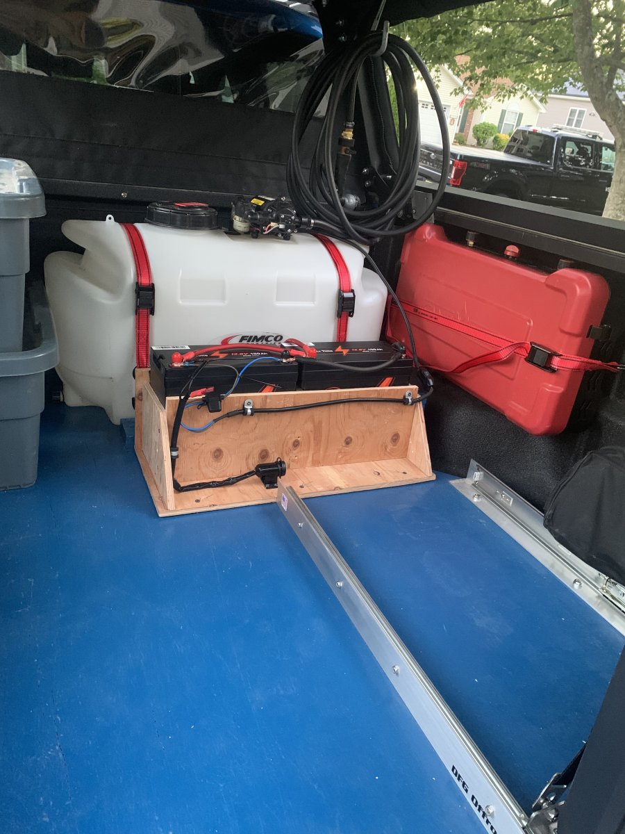

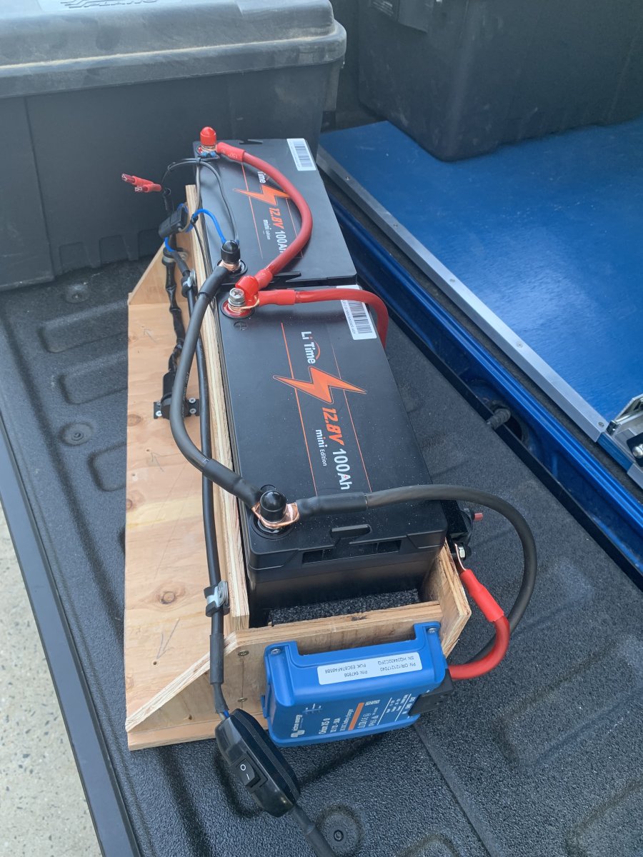

I made and installed a battery box to hold two 100 AH LiFePo4. I wired up everything for the DC to DC charger (Victron Orion XS), spray water system, Dometic fridge, and an Anderson SB175 quick connector so I pull the battery box when I need to. No, it’s not going to get a coat of paint until after the Vagabond trip.

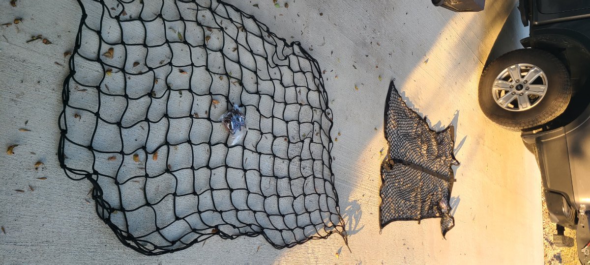

Got my stuff i won from muslogy auto for the 24 ranger. Two different bed cargo nets
