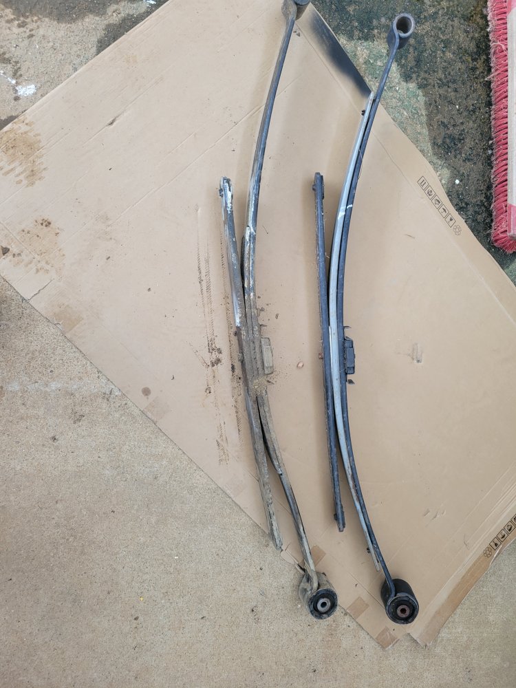

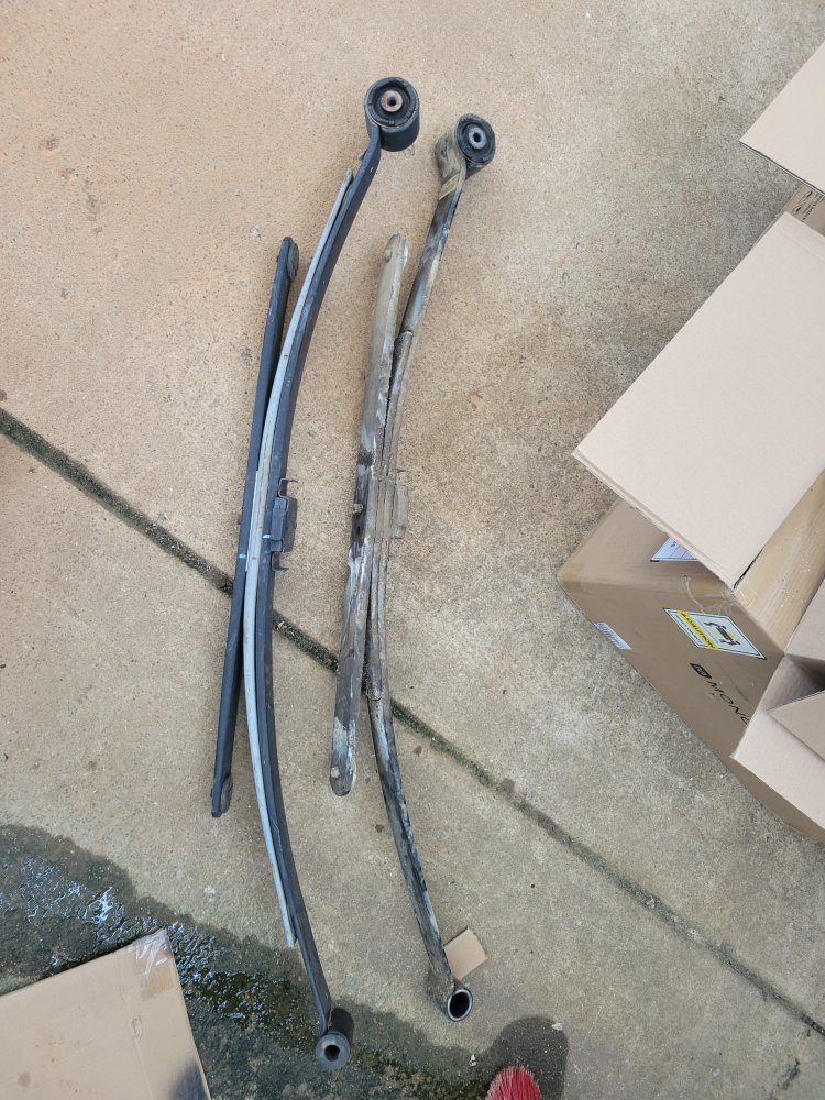

Well after the Round Mountain trip, I noticed a popping noise coming from the rear. I assumed it was the leafs since they've been squeaking since aboutv6 months after install. After further investigation I was correct. Last weekend I made a quick run down to GA and picked up a set that already had an add a leaf installed. So after work yesterday I tackled swapping them. When removing the old ones I noticed that the add a leafs were cutting into the mono leaf. Driver side had dang near collapsed down to the overload leaf and was banging off the bump stop. Glad to say swap went fairly easy. You will need a 21mm wrench to get the driver side off due to gas tank being right beside it. Now all done no squeak and back up high in the rear.
If you look you can see the bend in the front of the old leaf. Have no clue how that could happen hahaha. Speed bumps at the mall are getting out of hand. Plus these add a leafs have the round pads at the end to prevent them from rubbing into the mono leaf and notice how much longer they are. He ordered his through Stage 3 motorsports. I got mine from American truck. If you zoom in you can see where they had been cutting into the mono leaf. Not long and it would have broke.
I would have swapped to the Tacoma springs and been done with it.
I have a friend with the multileaf Taco factory springs. He says they are way too soft on the Ranger. He told me he hits the bump stops just driving on paved roads sometimes. Trust me I was on the fence since you can grab some OEM Taco springs for around a 100 a set on FB Marketplace.
