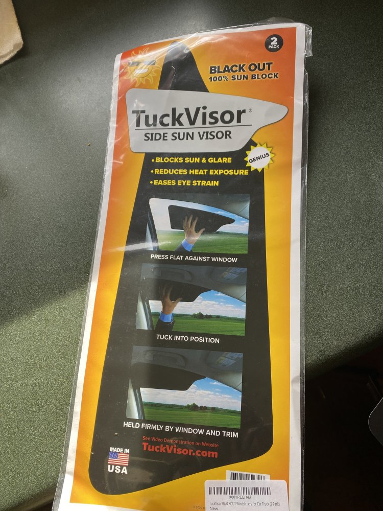

Got side window shades from Amazon. Most of my driving is north and south and I'm constantly moving the sun visor between the side window and windshield. We'll see how it works in the morning.

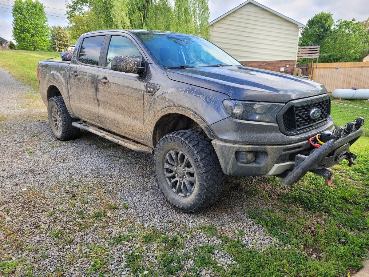

This is how mine looks most the time haha

Do tell me about that bumper setup! Look like it's not a bumper replacement, but rather a bumper addition? Please give me details!
CMOS
It's the Westin winch mount. I got it from Stage3 Motorsports. I spru g for the additional bull bar but drilled new holes and dropped it as low as I could. It sat up like a Baja bar on the front in predrilled location. I've actually used it a few times to clear trails and love how accessible the winch is. You will loose some of your approach angle. But I'm more overlanding that hard core wheeling.
Oh I forgot to mention. I also had the Rough Country tow hook swap to shackles so I used 1 existing hole the had for their hook mounts and drilled 1 new 1 in the back towards the bumper and bolted them on the bottom just to the inside of the tray mounting arms. I used 7/16 bolts since that was the size of the 1 preexisting hole.

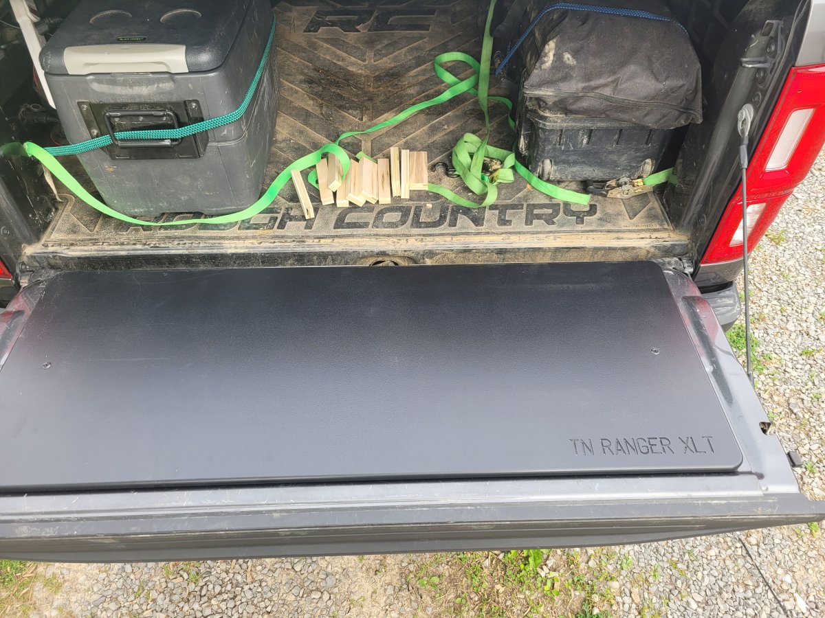

So on my recent trip through the Georgia Traverse I used my tailgate as a cooking station under one of those pop up canopies. I found that the impressions on the inside of the tailgate made it hars to level my stove and such for cooking. So I Googled those tailgate tables and found that they see around 300 dollars so I found some 1/2" nylon cutting board material at work and made my own. It's just screwed in place but I plan on adding some nut zerts and get some bolts with knobs so I can remove and clean easier.
