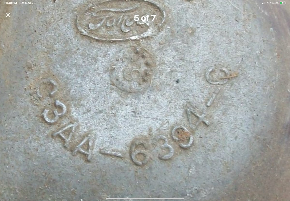

Was on eBay. Off a early 60’s mustang
After doing a google for that part number I would rate it not super desirable for a swapper. It is is for the older 5 bolt bellhousing V8's. Nothing really wrong with them but you would limit yourself to like the first 5 years of SBF production. A 6 bolt bellhousing would fit most 1965-2001 SBF V8's.
That's the servo cover ID number, not the trans ID. The "C" indicates the 60's, the "3" is for 63, the first year that part was used, the first "A" identifies the model- in this case fulll size car, the second "A" would usually be a Z for a Ford part or a Y for a Mercury part, I suspect "A" was for both, 6394 is the base number, indicating what the part is- 6731 would be an oil filter, 6009 is a block, for example. The "C" after the base number indicates the specific variant of the base number. The first 4 characters are the prefix, followed by the base number that will be 4 digits or more, then the suffix which can be one digit or more. In the 2000's, the prefix format changed when Ford tried to make things global . C5ZZ would have indicated a part first used in a 65 Mustang, now 2 digits indicate the model and I don't know the breakdown.
