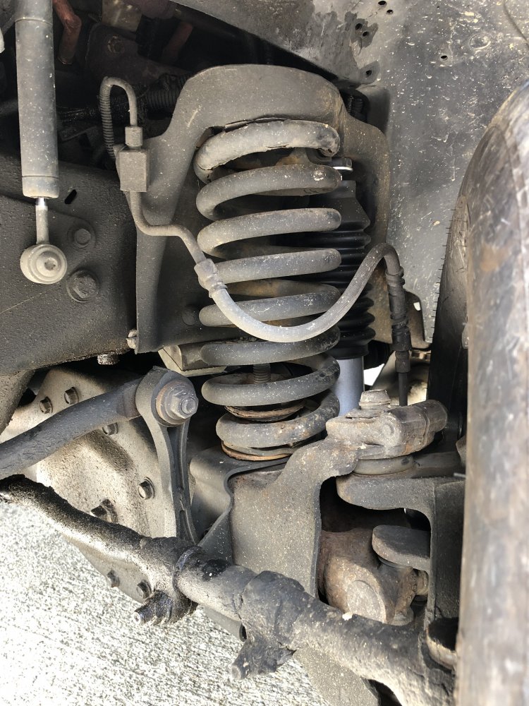

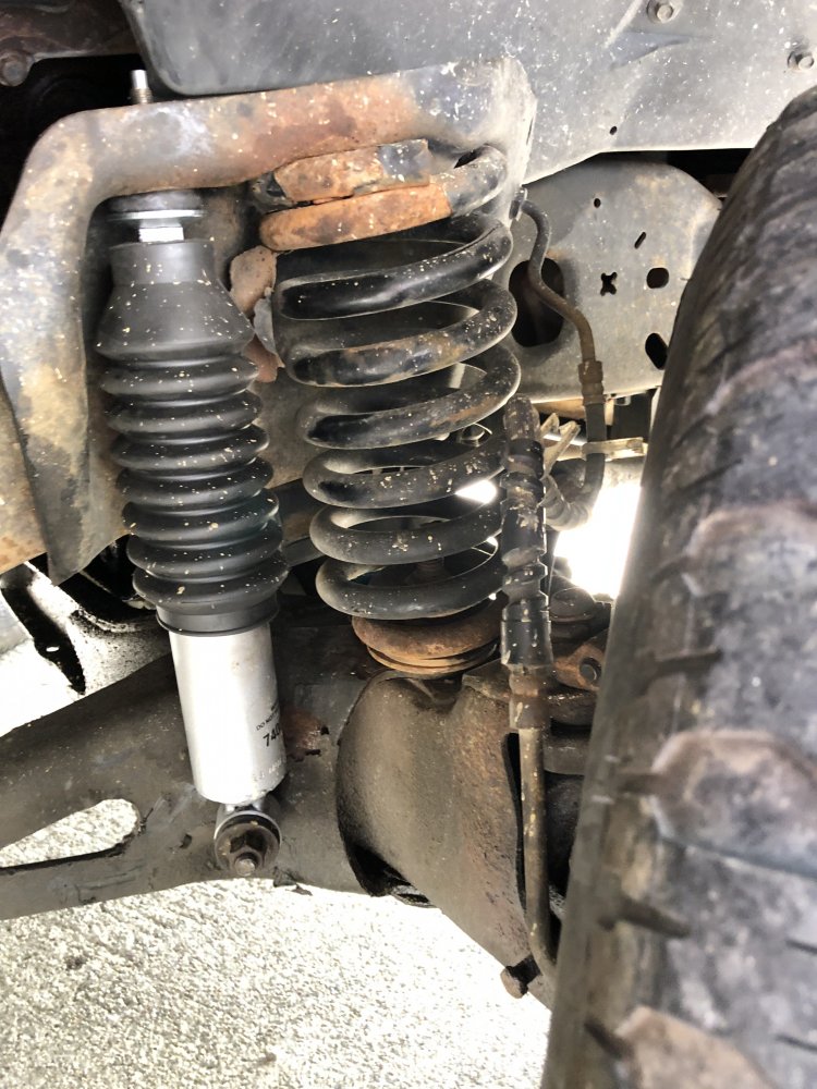

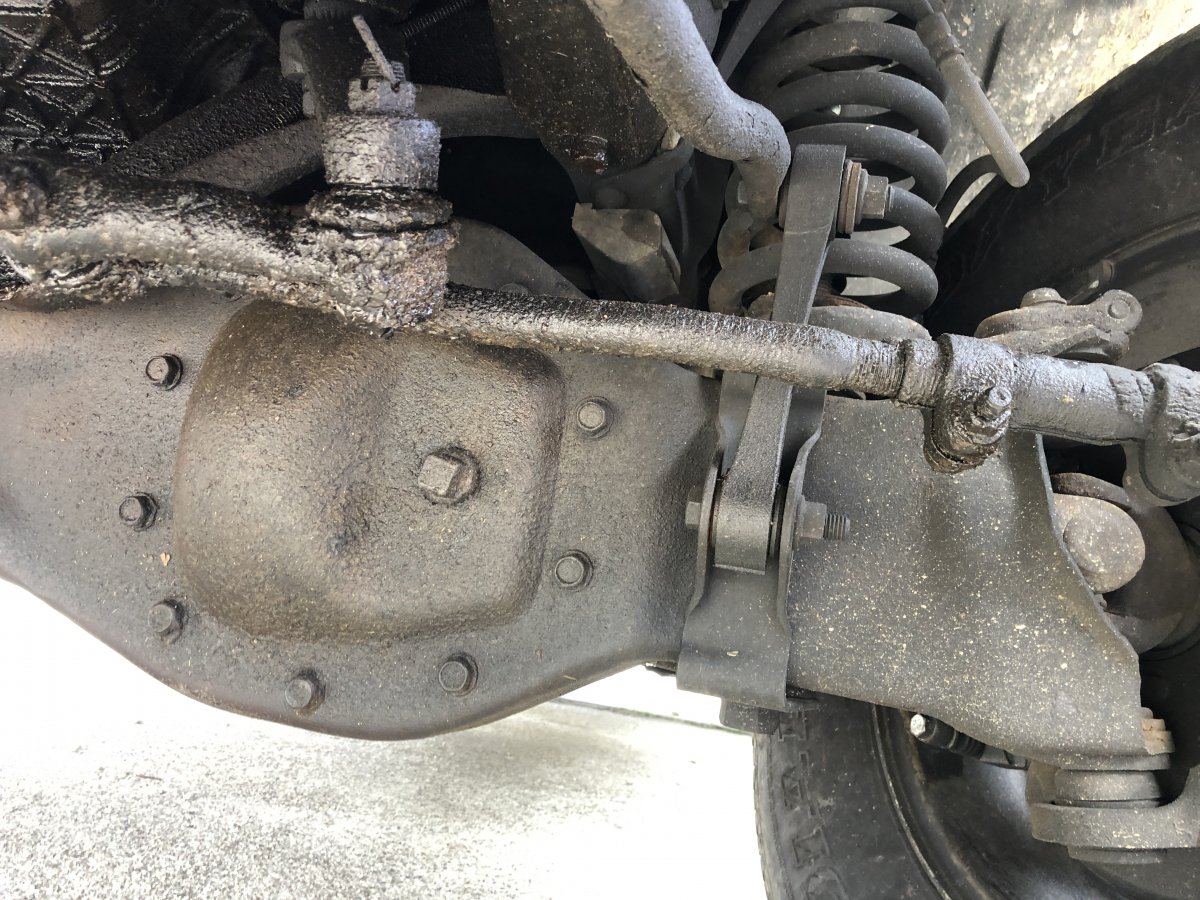

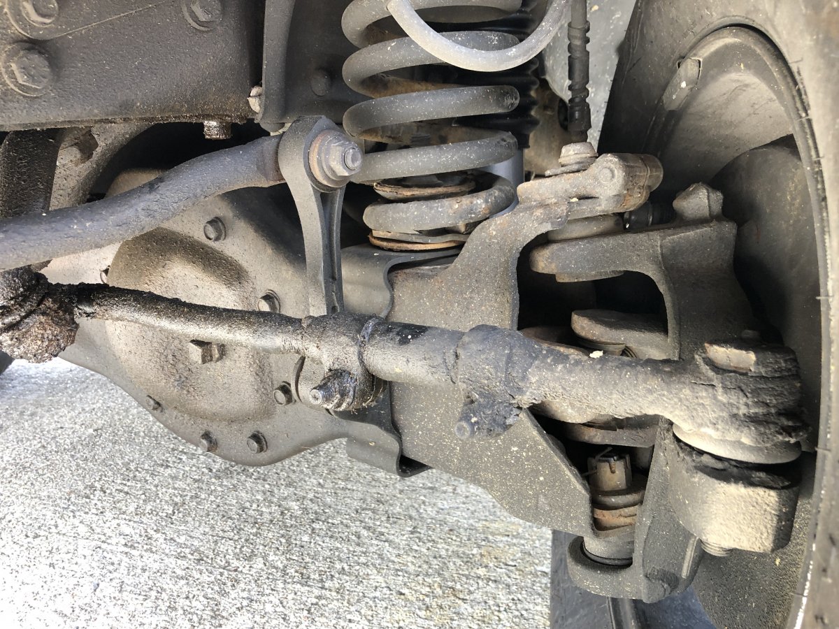

Ok, So as I look at this pics of my front end, and front what I read on the Tech pages, I have a Dana 28 Hybrid? A 28 inside of a 35? With the shock mounts being to the rear...?
Looking at replacing the coils. What else should I do while I am in there? Ball joint all look good and there is NO noise. NOTE: there is a small Power Steering leak and that is why there is crap on the linkage. Gonna hit the rear end soon but want to get the front end lined out first.
So as far as the springs are concerned, I would look for springs for a Dana 35? With the Pinch bolt design on the ball joints...? I am looking at the MOOG CC870 from Rockauto. https://www.rockauto.com/en/moreinfo.php?pk=201345&cc=1138160&pt=7512&jsn=13279&jsn=13279
Also, Does it look like the passenger side spring has been replaced? The right side looks a lot blacker and newer to me. MIGHT be part of the issue. Only one was replaced recently

I'll have to read the tech articles again. I would really expect a 97 to have a Dane 35.
