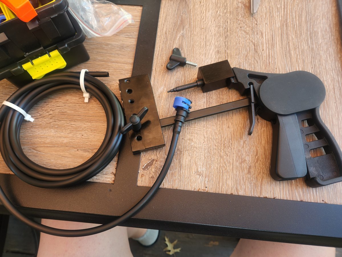

I just started my fuel line rework. The Dorman tool works with ease. It's warm today and didn't even use a heat gun. Pushed it right together.

I did notice on the truck the supply line switches from 3/8 at the tank to 5/16 leaving the canister filter. And the return line does the opposite. So this kit I bought doesn't nhave reducer fittings. So it looks like I'm gonna need two reducers to finish the lines up. They have nothing local so it's back to the internet...
So out of all this... I still need two fittings. 😩
I've got access to the same kit, the fittings are slightly different but still a big improvement over the factory stuff, I think this is the direction I'm going to go in. Surprising you can't find the fittings you need locally, everyone around here sells the fittings for nylon.
