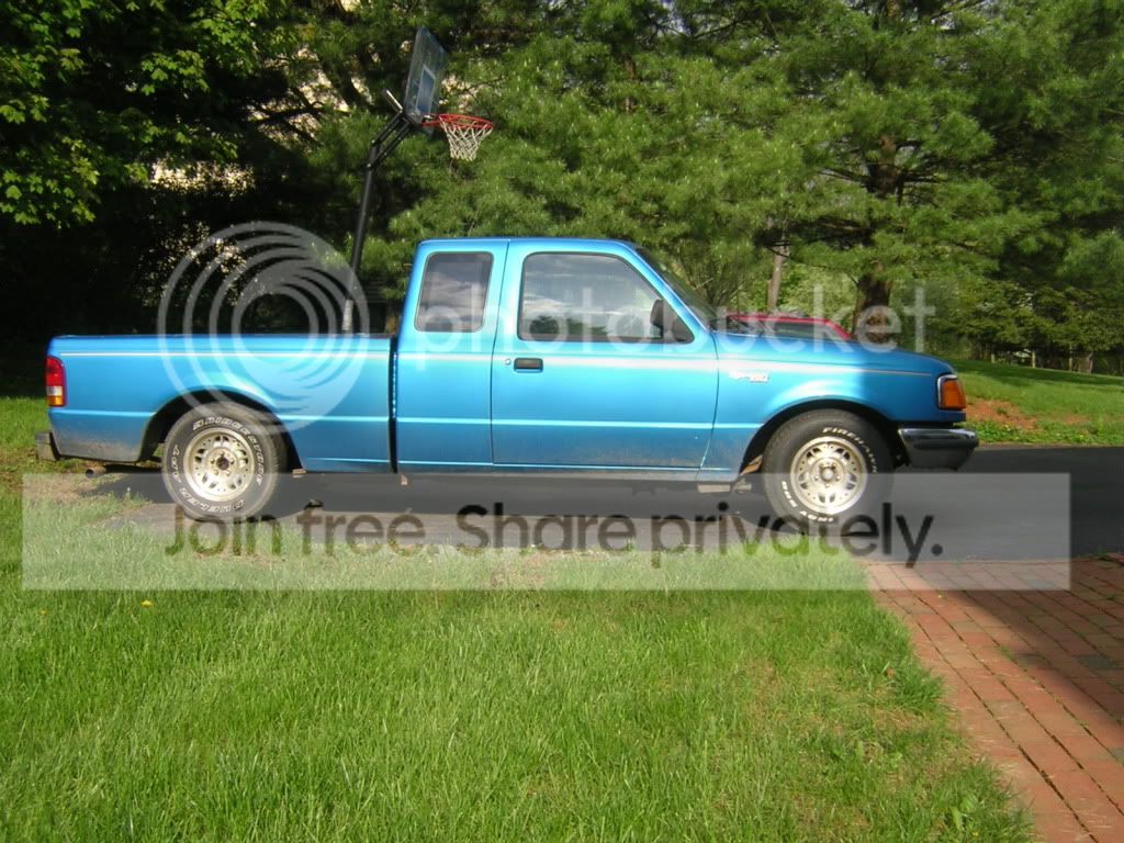

Finally finished phase 1
sorry for the delay, been busy with my daughters college graduation and doing chores that I had neglected during the drop.
I've been driving it for over a week now and no problems. It seem that I got the pinion angle right, I have no driveline vibration.
Here's a pic
Well... I've started my drop!
The Explorer swap went well except for one major hitch. You can not use the explorer lower shock mounts as stated in other posts. I fabbed some from 2" square tube and welded them to the axle tube similar to stock Ranger mounts.
If anyone would like more detains on the swap I'll gladly post them.

Thanks.. I have a CNC machining center available to me!
I was gona say they look to good to be done with a plasma/ grinder and a drill lol

hey 2old4this just seen this. i've got one just like it color and year.was thinking of dropping a few years ago.now i know what it would look like..cool looking..i like that.
had to take another look......great machine work!!!!!!!!!!
