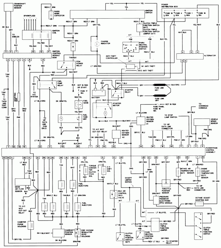

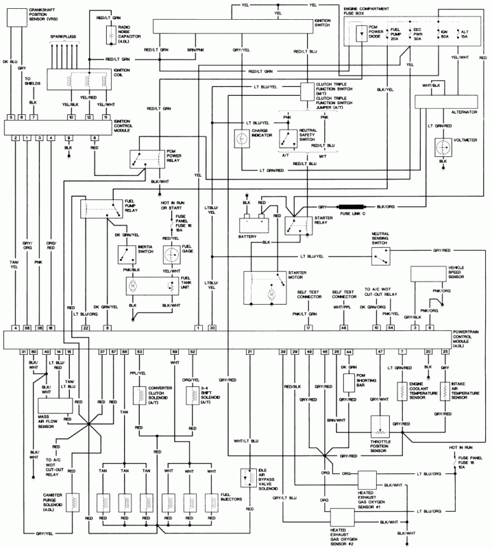

93 94 ...diagrams you can see the differences to the pcm and injectors
