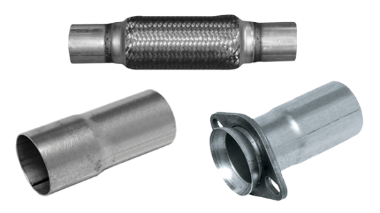

I like the bell flare connectors Walker makes better- no gaskets and you can swivel it around to suit you. I weld the male end of the connector to the pipe in front and the female end to the rear section but you could switch it if you want. I couldn't find a picture of the male end but the lower right piece is the female end. No more leaky gaskets.
I think this might be the solution. I could weld the one on the bottom right to the muffler and use a donut gasket and spring bolts.
You dont use a donut with that setup if you use both the male and female end. Its self sealing like a compression fitting.
