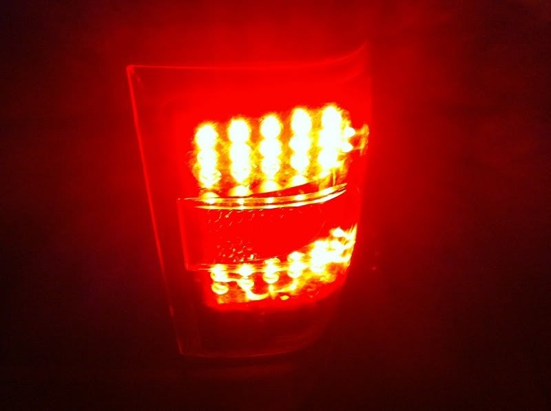

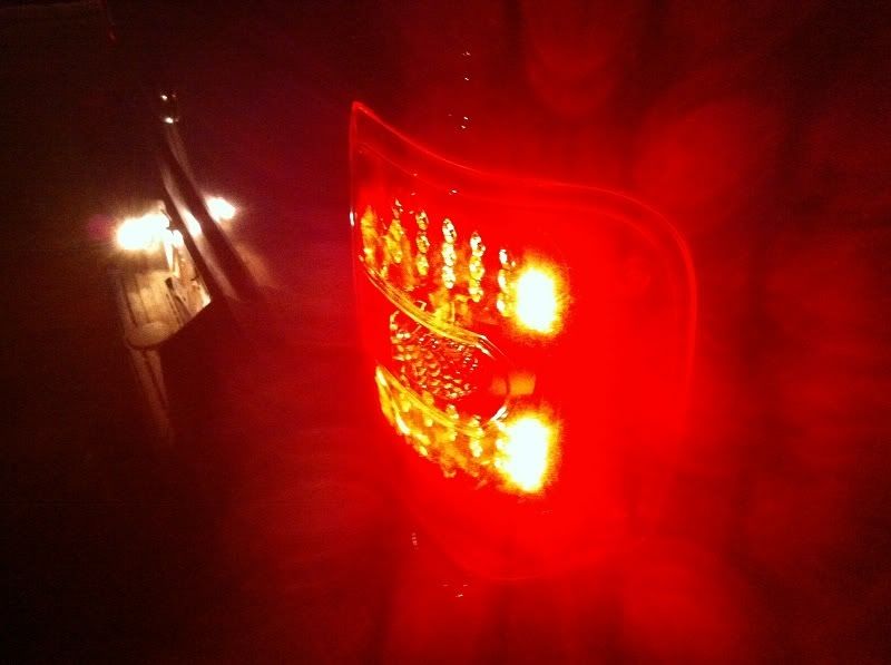

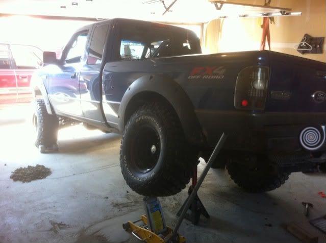

i totally realized i haven't posted my tail lights yet... i'll do that... tell me what you guys think about these fx4 decals for the fenders...
will post tails asap
nice those tails are awesome and not too flashy for an off road vehicle. likem!

actually the springs aren't much different than my stock ones, i was not impressed... they are a little stiffer, but not by much i took the block out, and put belltech 6400 shackles in, though i am changing the mounting point on the shackles, and putting the blocks back in pretty quick, as i need to limit the flex on it my truck, due to my fenders and tires getting chewed up

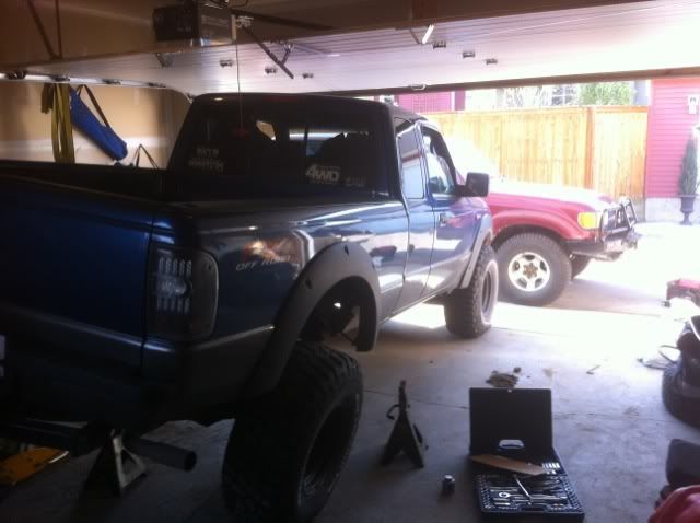

ok, an update, since i did the lift, and tires, my rear tires have been hitting the flares and actually bending the box sides... not wanting to do any cutting, nor lose my flares, i decided it was time for bump stops... my first thoughts were to put my 3" blocks back in, as they have bump stops on them, then just change which spot of the shackles i use (belltech 6400) so the shocks don't over extend...
well, i went to do this, and luckily, i didn't need to... i pulled the rear u-bolts off, and had an epiphany! i could put the blocks on top of the spring, this way i don't have the axle wrap issue, and flattening of the springs... looking at it, it wasn't going to work as i had planned, because of the center bolt on the springs, so i flipped the blocks upside down, and placed them between the plate that the nuts on the u-bolts go into, and the spring, the bump stop is upside down and sitting funny on the rubber frame side of the stop, but that will be fixed later...

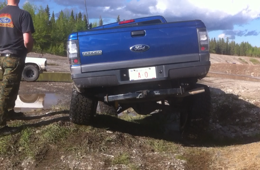

however on sunday i was at a 4x4 training session, and managed to totally flex my truck out, this pic was taken with the rear passenger side tire off the ground by about an inch or so... belltech's and expo leafs make for a decent amount of flex!
