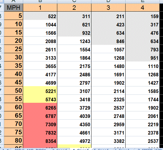

Well, did a few calculations. So here it is:
4R44E - 2.47 / 1.47 / 1.00 / 0.75
26" tire
3.27 gear ratio
RPM numbers don't account for true tire radius, so take them as approximations. Hopefully they'll be to your liking. :icon_thumby:

thank you for that. I did a quick calculation myself and came out around 1800rpm for overdrive(4th) at 55mph. According to your chart I may just pull a 3.55 8.8 from one of my 4.0L 2wd trucks. 3.55 just may be as low numerically as I can take the truck in stock form while still retaining enough power to not downshift on any incline.
1500rpm at 50 would be a definite downshift and mileage killer on any incline with 3.27 gears.
