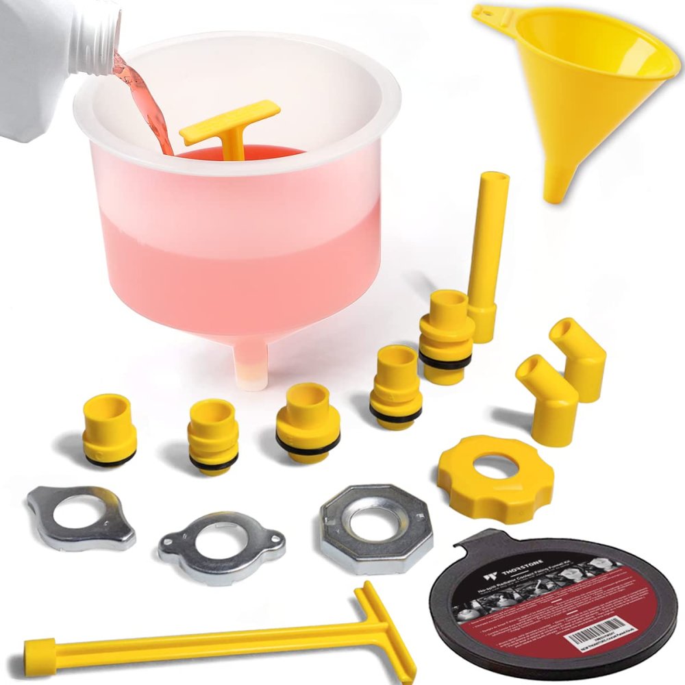

I know this wasn't the point of the thread, but I replaced the sender and now the temp gauge just goes from minimum to maximum in about 30 seconds of driving, even though the radiator or inlet hose isn't very hot. There's no way that's right. Also, I tried to get the air out of the coolant by putting a funnel on the radiator cap and filling it with coolant, then letting it run for 10 mins. No bubbles ever showed and the radiator was cool until I started driving, even though the temp gauge was above half way and continuing to go up while idling

When engine is cold take one heater hose off at the firewall, doesn't matter which one
Refill radiator until coolant is coming out of firewall AND hose
Put hose back on
ALL the air is out
The heater is on the engine side of the Thermostat, rad cap is on the radiator side
When engine is cold thermostat is closed
So when you refill cooling system air gets trapped in the engine/heads behind thermostat
Heater hose is at rad cap level, so with a hose removed coolant can push the air out as you refill via radiator cap opening
Easy peasy lemon squeezy

Maybe a bad sender. I got a Standard TS374, which looks exactly the same as the one you sent. I already replaced the cone shaped tip one. The funnel I was talking about is this one pictured. I've used it to get the air out of the coolant before, just filled the funnel up, let it run until operating temp, then it sucks the coolant down.
