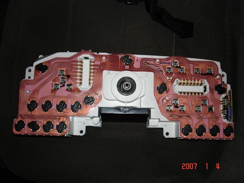

Does anyone know where i can find replacement bulbs for the warning lights and the plastic holder for them? They are for an '86 ranger and they aren't the normal sized bulbs found to light the backround of the speedometer but are for like the brake, 4x4, and lo range warning lights. I looked at autozone and O'reily's and they couldn't find any. I checked out ebay too with no luck. I guess a junkyard would be the best bet? any other ideas?
I had the same problem, just grab a handful now every time I go to the wrecking yard when ever I see a cluster that has been taken out.
really? they arent just regular 194 bulbs? they are on gen III trucks...
i don't know the number off hand but they are smaller than a normal bulb for the backround of the guages.
I just told you the number...it's either 73 or 74.
