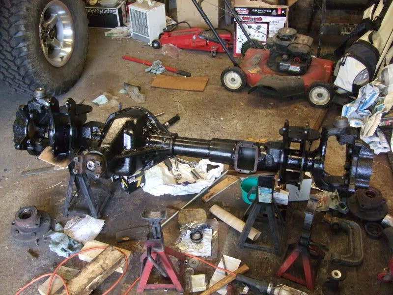

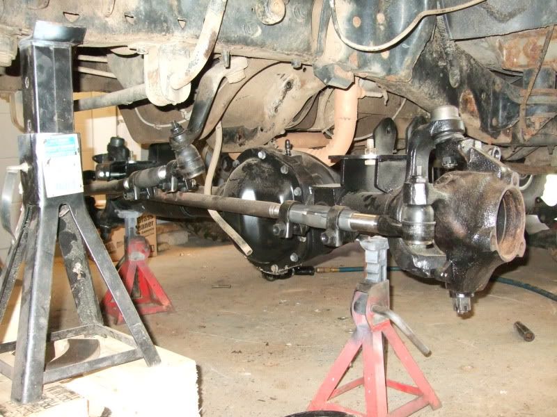

Old thread I know but here is what I'm working on.
Dodge ram axle narrow to Waggy width with waggy axle shafts using Ballistic fab brackets.
Stay coils if you can because you can "tune" your truck alot easier with coils.
Coil rates, lengths and position are all benefits.
The width is great with the waggy width.
Those dodge knuckles with the unit bearings are strange, never seen one before. Why don't you run different knuckles? Is this the dodge unit bearing for 5 on 4.5 I've read about? Did you narrow both sides or just the long side?
