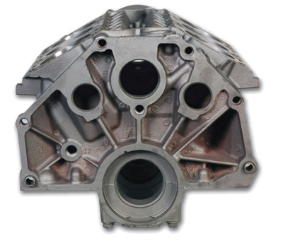

3.0 Duratec block

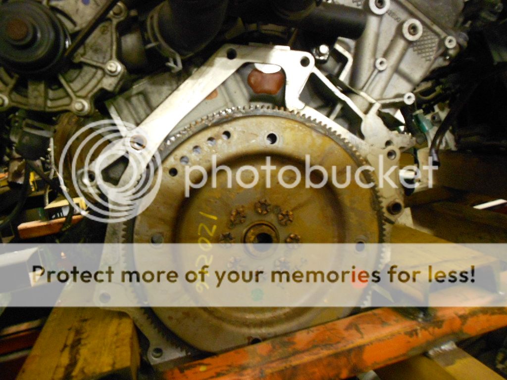

3.0 Vulcan
I don't need a tape measure to see they are different.
Where did you get these pics. I would like to compare and contrast that Vulcan with the Conti 4.6, but cant find any good pics
