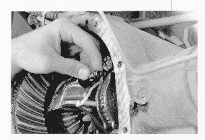

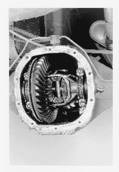

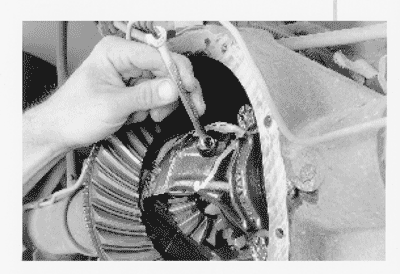

To remove the axle, first remove the rear axle cover and drain the fluid
vibration rear at speed
To remove the axle, first remove the rear axle cover and drain the fluidNext, loosen the pinion shaft lock bolt ...
Next, loosen the pinion shaft lock bolt ...... and remove it from the axle carrier

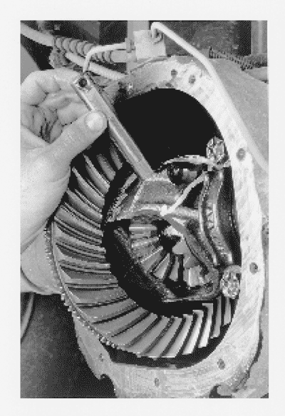

    1. Remove the differential pinion shaft lock bolt and differential pinion shaft.
The pinion gears may be left in place. Once the axle shafts are removed, reinstall the pinion shaft and lock bolt.
  1. Push the flanged end of the axle shafts toward the center of the vehicle and remove the C-lockwasher from the end of the axle shaft.
  2. Remove the axle shafts from the housing. If the seals and/or bearing are not being replaced, be careful not to damage the seals with the axle shaft splines upon removal.
  1. For 3.73:1 and 4.10:1 ratio axles:
    1. Remove the pinion shaft lock bolt. Place a hand behind the differential case and push out the pinion shaft until the step contacts the ring gear.
    2. Remove the C-lockwasher from the axle shafts.
    3. Remove the axle shafts from the housing. If the seals and/or bearing are not being replaced, be careful not to damage the seals with the axle shaft splines upon removal.

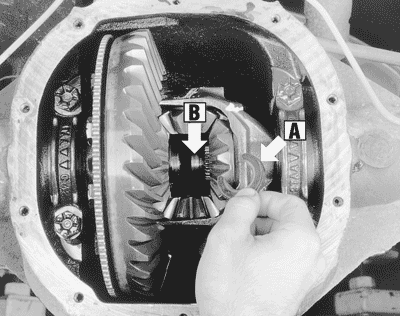

      Pull the pinion shaft out of the axle carrier. DO NOT rotate the axle with the pinion shaft removed!
      Pull the pinion shaft out of the axle carrier. DO NOT rotate the axle with the pinion shaft removed! Push in on the axle flange (wheel side) and remove the axle C-lock (A) from the end of the axle (B)

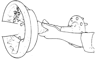

Slide the axle out of the axle tube. Use care to not damage the bearing or seal

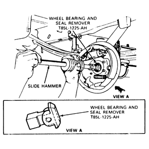

  1. Insert the wheel bearing and seal remover, T85L-1225-AH or equivalent, and a slide hammer into the axle bore and position it behind the bearing so the tanks on the tool engage the bearing outer race. Remove the bearing and seal as a unit.
Axle shaft seal and bearing removal

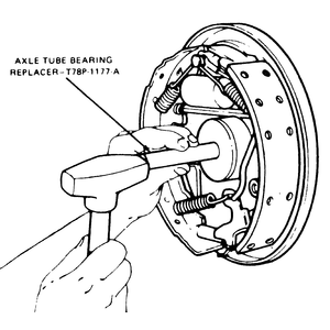

  1. If removed, lubricate the new bearing with rear axle lubricant and install the bearing into the housing bore. Use axle tube bearing replacer, T78P-1225-A or equivalent.
  2. Apply Multi-Purpose Long-Life Lubricant, C1AZ-19590-B or equivalent, between the lips of the axle shaft seal.
Axle shaft bearing and seal installation
8555 images-85557077
  1. Install a new axle shaft seal using axle tube seal replacer T78P-1177-A or equivalent.
