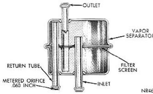

After a lot of research online about my truck sputtering and losing power for 1-3 seconds only on hot days, it seems that vapor lock is the culprit. I found a YouTube video online that describes my exact symptoms and how to resolve it. Short answer, vapor separator fuel filter. See video below.
The installation seems very simple. My question: is this small line on the charcoal canister a vapor return line to the fuel tank? If so, would it be safe to use on the vapor separator fuel filter?

The small line is not a return to the tank. There is a check valve that plugs into a rubber grommet on the top of the tank. As pressure builds in the tank, vapors are vented from the tank, through that line, where they’re stored in the charcoal canister until the computer opens the canister purge valve solenoid.
Nothing is connected to the carbon canister in your picture. Vapor lock happens when fuel in the fuel line becomes to hit and turns to vapor before entering the carburetor float bowl. It is very unlikely this is your issue.
