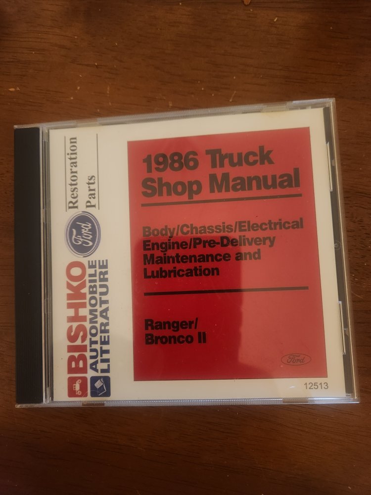

Well I was up early and dug deep into my messy desk and found my CD.
The problem I have now is my computer asked me... what would you like to do with the blank disc. No idea how the information got wiped from it... but it's blank.
That said... I wasn't super happy with the content. It seemed to be lacking a couple things I went looking for. I know one thing was window glass adjustment and any power window information in general.
It was a large .pdf file... it was searchable but it was clunky.
I'm going to look for something better to replace it.

Maybe it is not wiped, maybe your newer machine simply refuses to see it.
I have an older computer specifically for older file types, in fact my 93-94 cd was written and published before Windows 95 had even been heard of
The machine I use for older stuff has XP on it, not really that long ago
