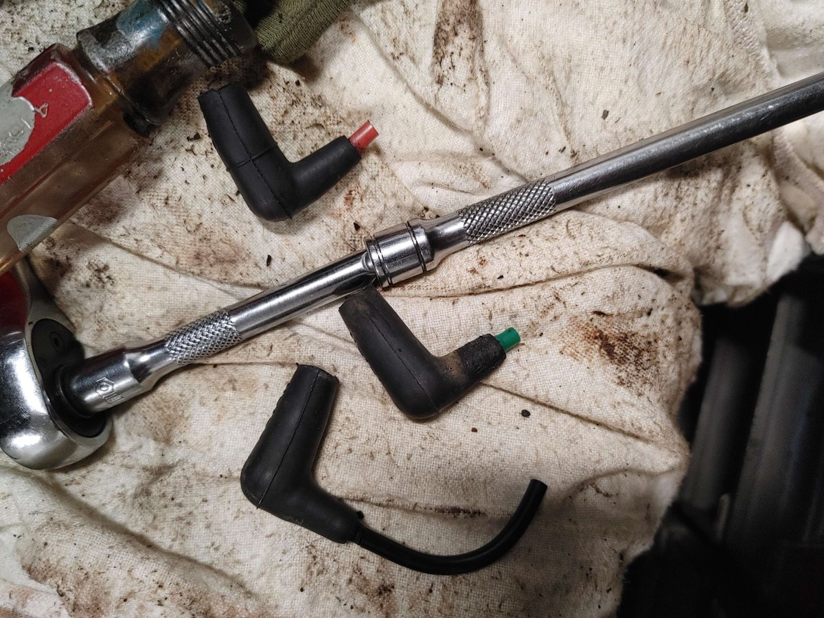

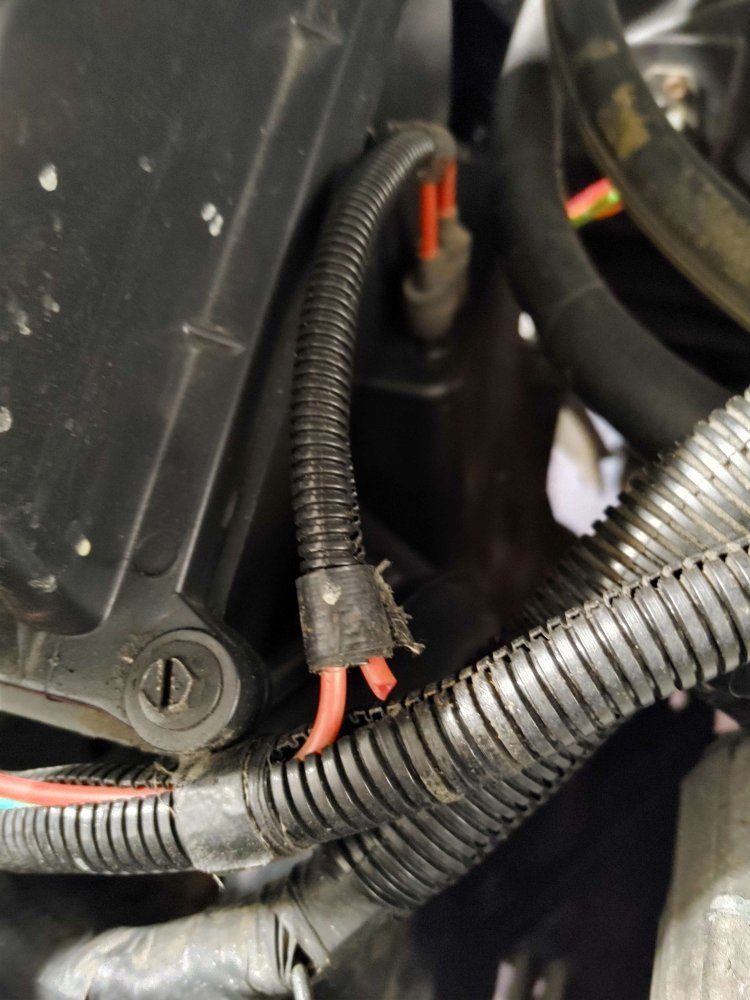

I was replacing the lower intake manifold gasket on my '86 2.9 and while moving junk out of the way, I noticed I accidentally snapped 3 different plastic vacuum lines, they were so brittle its like raw spaghetti. One red, one green, and one small black line. Wasn't sure where to post this so sorry if it's in the wrong spot. Do these have a specific name? Where would I even find replacements?

They do sell specific plastic replacement stuff, but I usually just end up using rubber hose of the right size, lot of that stuff is about 1/8” so I got myself a roll since I deal with it often.
