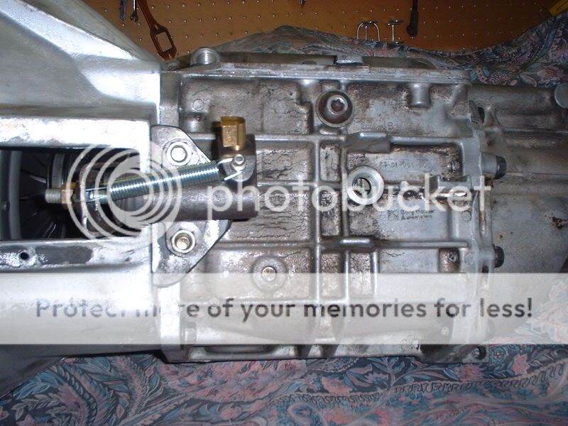

There are many options. Some have used the stock slave from an early '83' (?) Ranger, some have used some that Summit sells. The cheapest is probably one out of a '81 Nissan 280 ZX found at your local NAPA/Car Zone parts store, run under $20
Fab up a little angle bracket, get some braided hose and the proper fittings and short piece of rod.
Dave - sorry for the size, snagged it from another site.

oh thats niice!
If you got this style of fork(where the pivot ball is at the other end rather in the middle) make sure that the slave is functioning in the right direction.

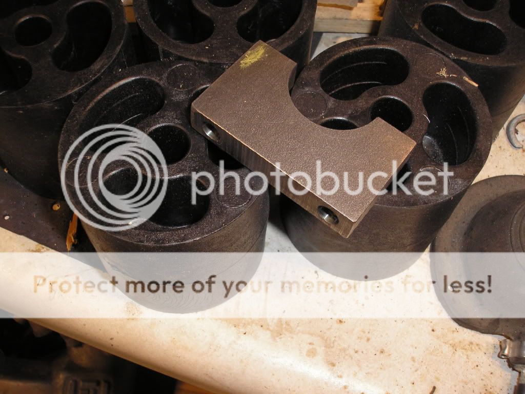

I had the machinist at work mill out 2 blocks that clamp on the cylinder and made a bracket that bolts to the tranny itself. Very easy to do, a lot easier than figuring out a cable setup.

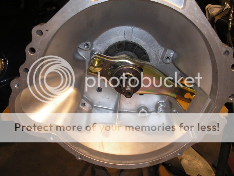

Here's what the stock '83' slave looks like, think he used the stock hydraulic line and master for this swap.\
Dave
That's the pull type vs the push type, not sure there is room in front. Don't know.

Awesome. Thanks for the pics and tips guys. The pics are a HUGE help for me.
Does the M5OD in the F150 use the around the input shaft style slave cylinder/release bearing assembly like the Ranger trans does? I'm not sure if I want to go that route because it's a PITA to service if something goes wrong. They also usually cost more. On the other hand, it's not all that hard to drop a transmission out for a day.
