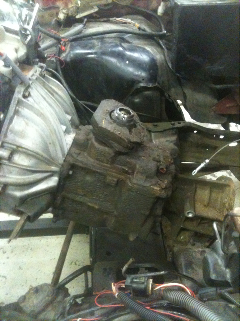

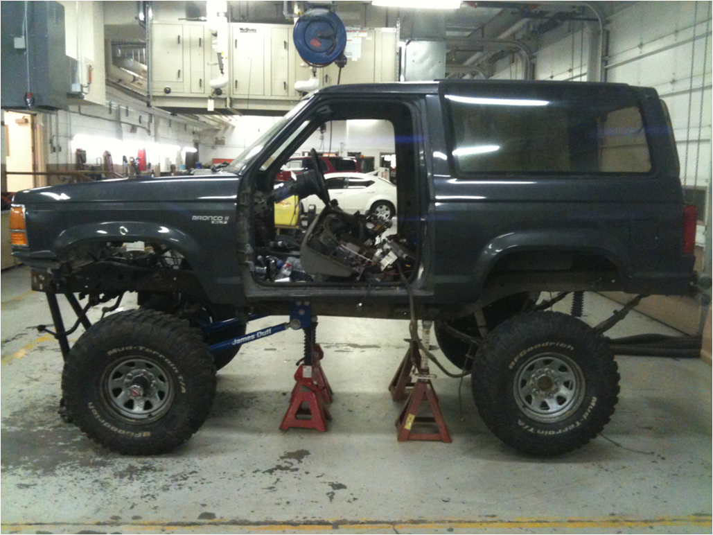

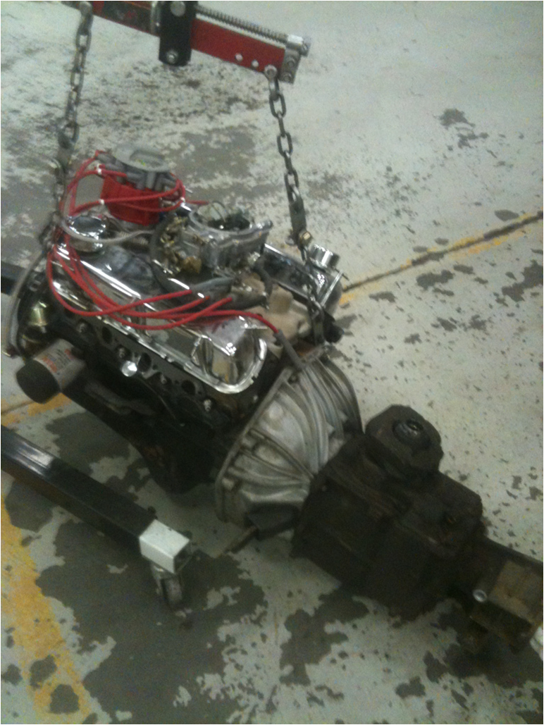

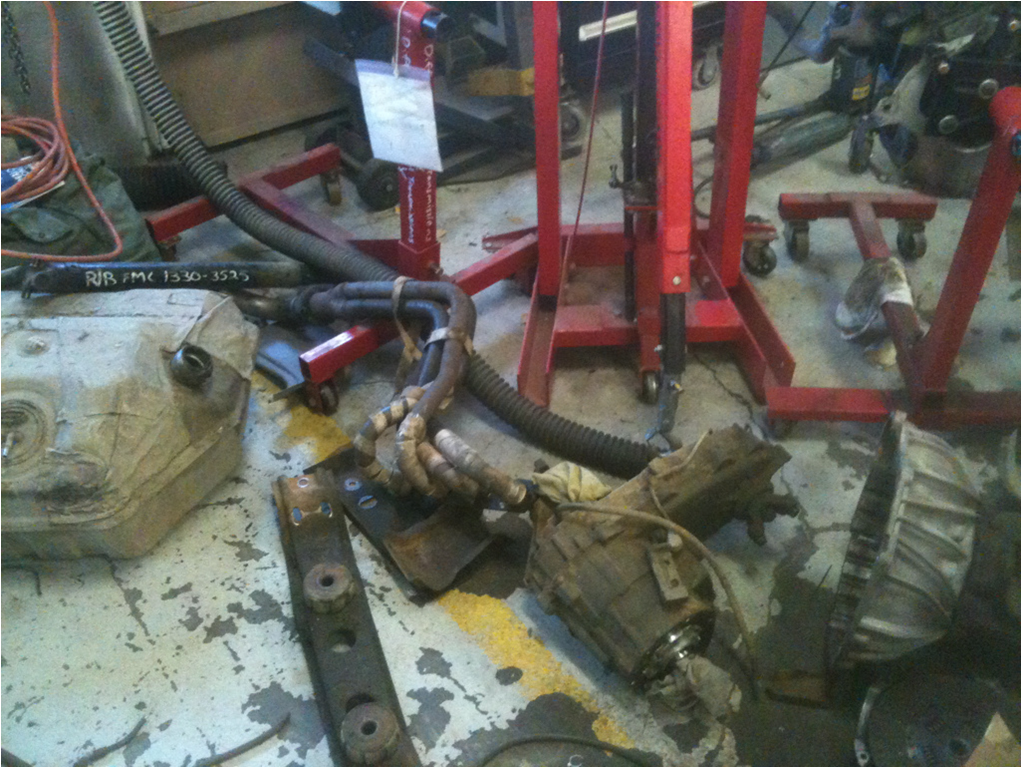

Hey all,
So I have been working on a V8 swap for awhile now and have run into a sticky situation. I took the motor, tranny and transfer case out of an 82 bronco and am trying to put it under my 90 BII. I have a 3in James Duff suspension lift and a 2in body lift on. I also swapped the rear axle and front TTB setup from the 82 bronco. Had to modify the drop brackets a bit but it sits nice now.
My original plan was to just slam everything under the BII frame and body but apparently the transfer case is to wide for the BII frame rails. I got ahold of a NP205 but it is not matching up to the tranny. So now I have the original transfer case from the 82 and an NP205. I got rid of the original 2.9, tranny and transfer case as swaps for help on the project.
The motor and tranny are in. The running gear is in and lined up nice. All of the suspension is bolted in. This darn transfer case is my only hold up. Any ideas??

Have you considered using a 1354 transfer case?
I can't tell which transmission you have, but can you adapt it to the smaller case?
I am using a 1354 behind my AOD in my Ranger. People say the smaller case will hold up to a V8 (mine is not running yet, so no personal experience...)
The 1354 won't bolt to a fullsize transmission without adapters. I'm taking it that your NP205 issue is the shift rail is in the way hitting the extension housing. No big deal just grind a notch out of the extension housing and bolt it up. If you are unsure where to grind most transmission shops have t-case gaskets and 99% of them have a tear out notch just because of the older NP205 setup. Trace the gasket and you are good. Hopefully that should solve your issue.

I've got a 5.0 with f150 trans with transfercase in my ranger so u can make one fit in a BroncoII just takes some work. I had to cut some of the webbing off the side of the t-case and make it so the motor/trans is slightly crooked to the frame to give more clearance for the t-case which actually worked out nice for me because I have a 9in with equal length axles so my 3rd member was slightly offset anyways so now they are straight in line with eachother instead.

I bought an F250 and took the entire drive train from that and am still putting that in my ranger. 302 -> AOD -> NP208. I had to notch the frame for the NP208 to fit but being a t-case from a full size pick up it should have no problems.
