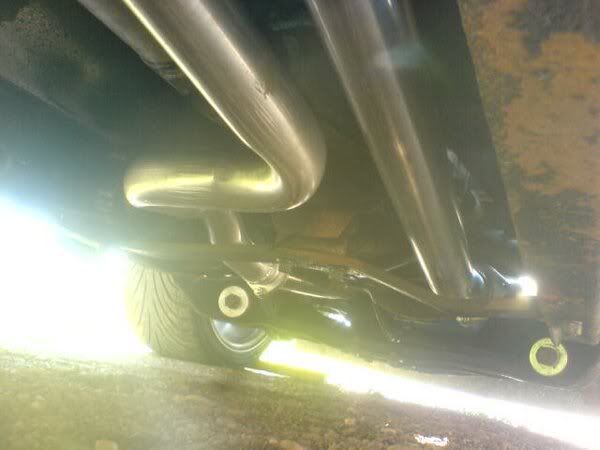

Do tri-ys hang below the frame? I plan on doing a v8 swap in my bagged 94 and havent decided on headers. Im also running an aod, is there any problems there?
Edit: nevermind found more info by looking at all of the pages in this thread. Im looking at this on my phone lol. The tri-ys are for a mustang correct?
Pics in post #12 of this thread. For a 2wd they are what I would go with, they do take a little work to clear 164T bellhousings as noted later in this thread.
Just another confirmation, they do not hang lower than the frame.

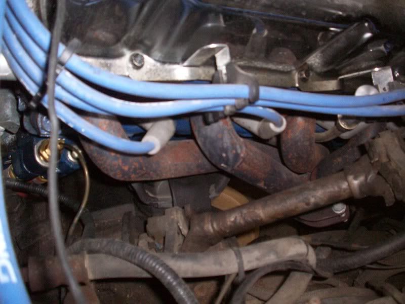

I am trying to fit BBK 94-95 Mustang unequal length shorty headers on my 302, in a '93 4WD truck.
The engine a little high - I made plate mounts for use with factory motor mounts, and raised the engine 1/2" over that (oil pan and suspension parts clearance.)
The passenger side fits - need to clearance the frame to allow the pipe to pass.
The driver's side - :( Minor clearancing of the frame for the collector, but the #2 tube and the steering shaft want to occupy the same space.
I am going to have to modify the header tube.
