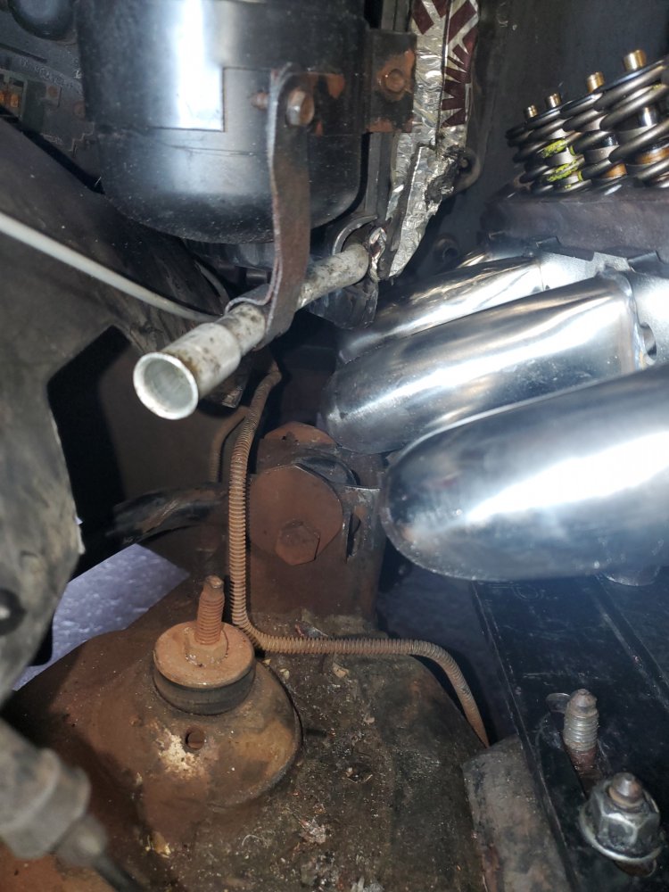

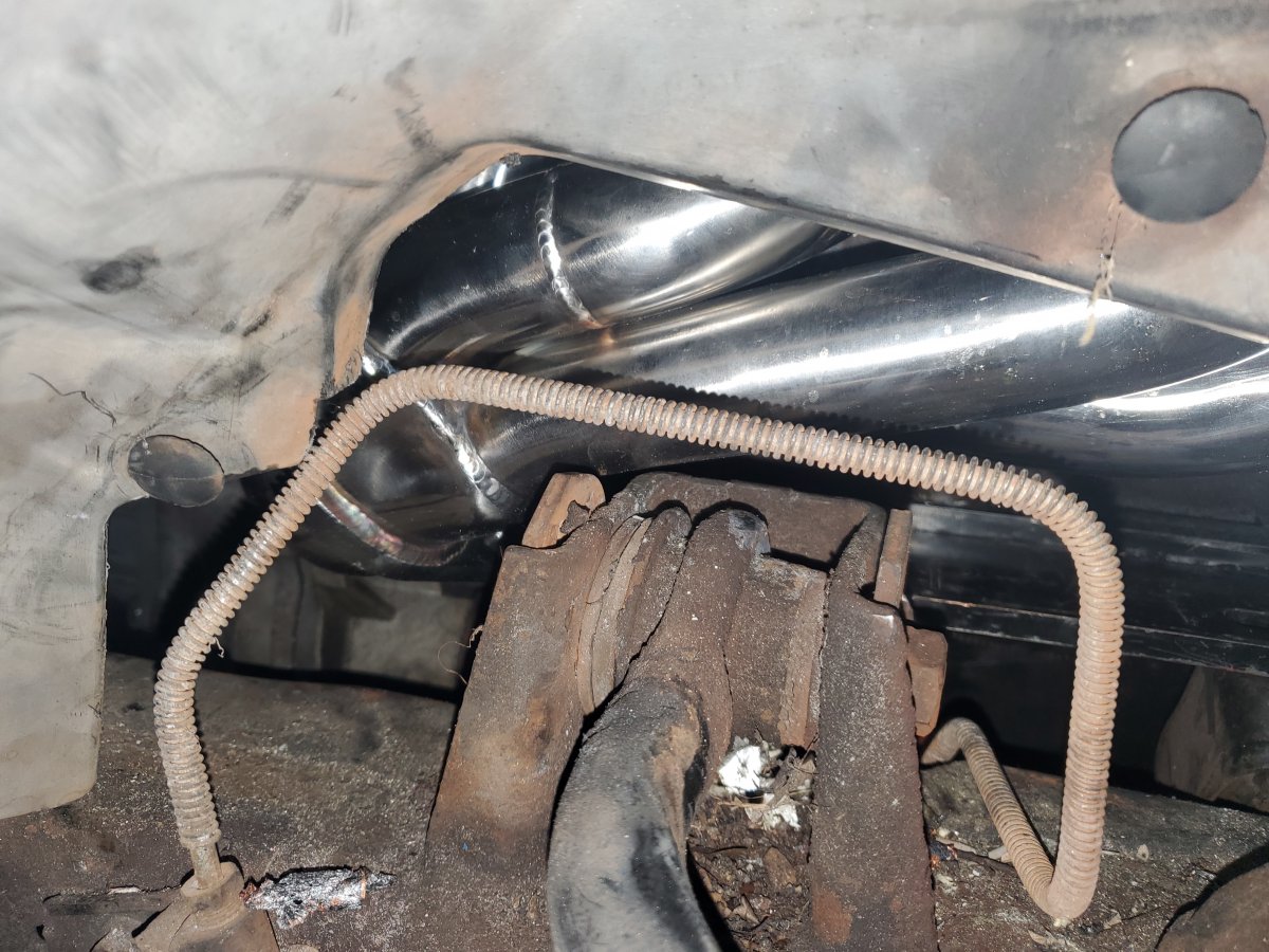

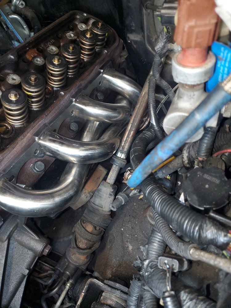

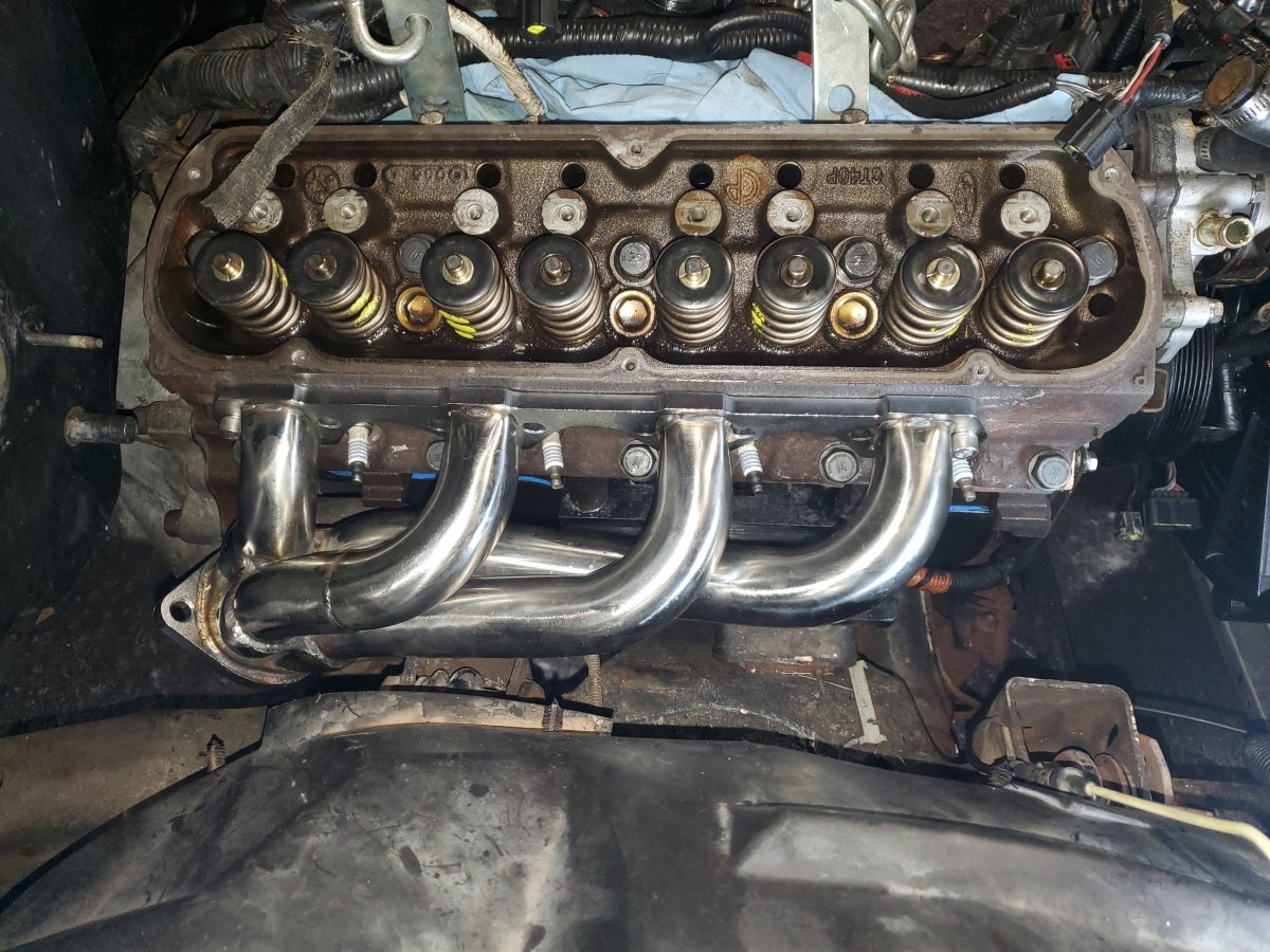

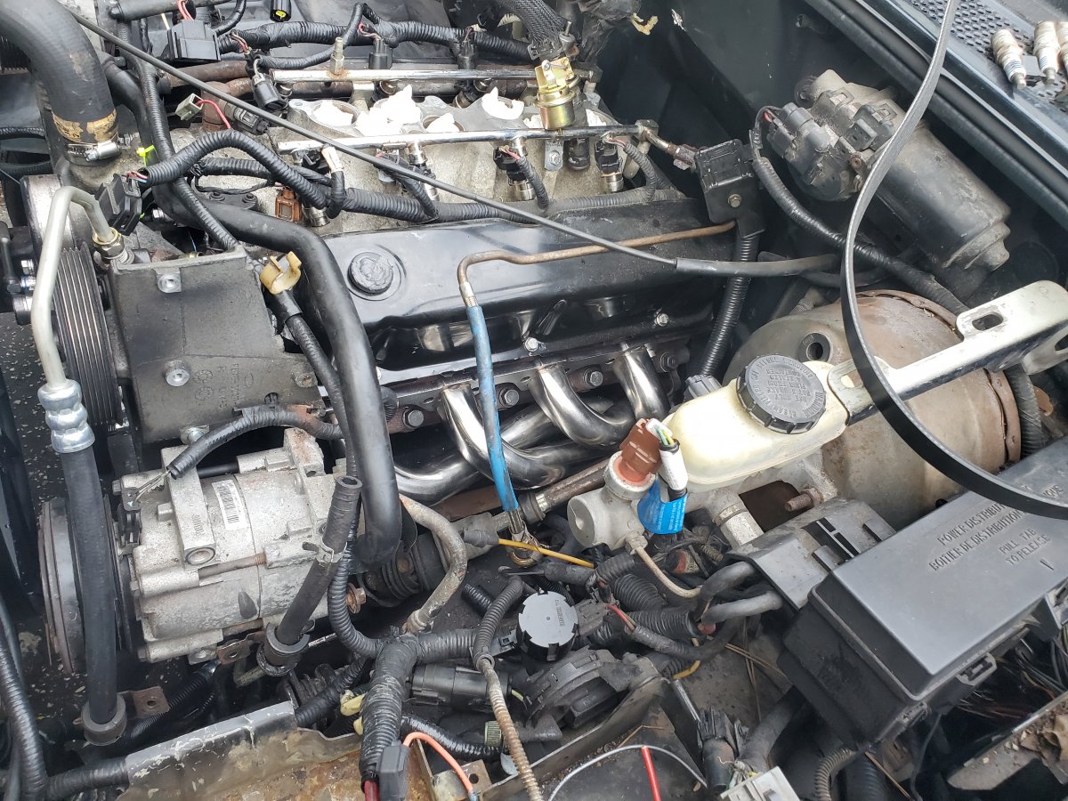

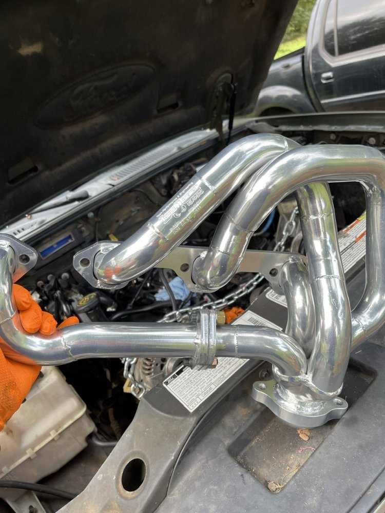

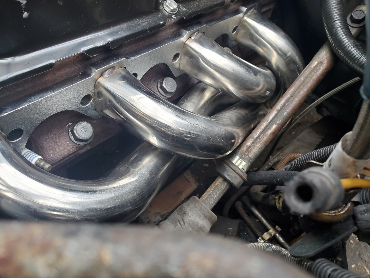

I bought some stainless shorties for $140. A little dent in one spot and it should bolt up. Drivers side is pretty much In place. I'll be back with photos for the
passenger
  • V8 Conversion Headers

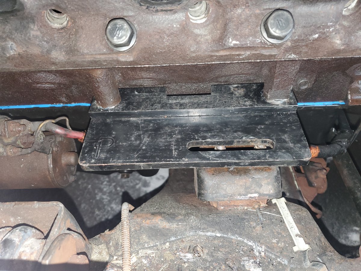

Ok so I added this spacer that is meant for the driver side motor mount to the passenger side
63312
Then I bolted it on the motor mount to dry fit the rest and my passenger side now has clearance barely.
63316
63313
I'll be doing a little dent there and at the steering shaft. Ac also will have some space.
63314
63315

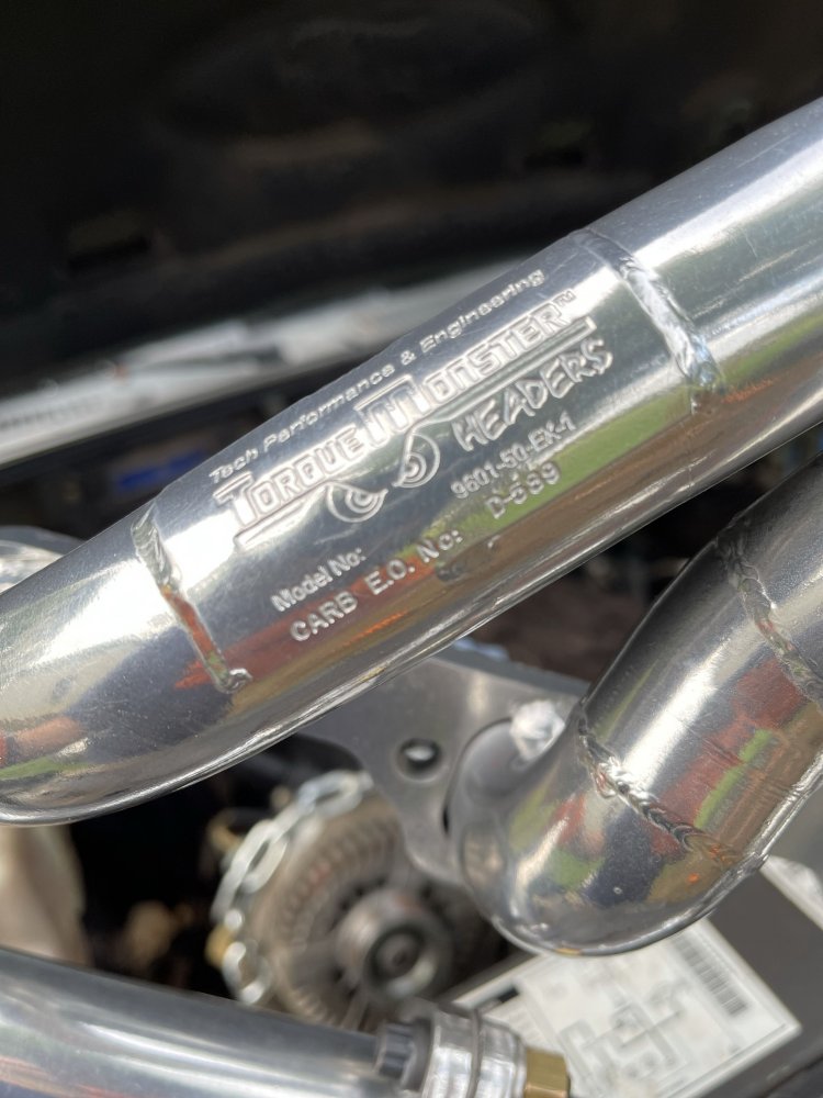

Has Anyone had a recent experience with ordering torque monster headers. I was was under the impression that Bob (person who's contact info is on the website) made the headers him self but apparently that's not the deal? I placed an order on March 17. Just wondering what the most recent someone got headers from them and how long they had to wait.
Spiffy, I ordered mine from TM headers in may 2020, received them like 5-6months later, closer to 5 months. Keep in mind this was basically before Covid got all crazy. I actually spoke with Robert P. maybe a month after ordering, so like June 2020, he was having some supply issues back then. Overall, I was completely satisfied with mine, they are ceramic coated inside and out, very well built! But just wanted to give you my ordering experience. I knew of the wait before ordering, well worth it.

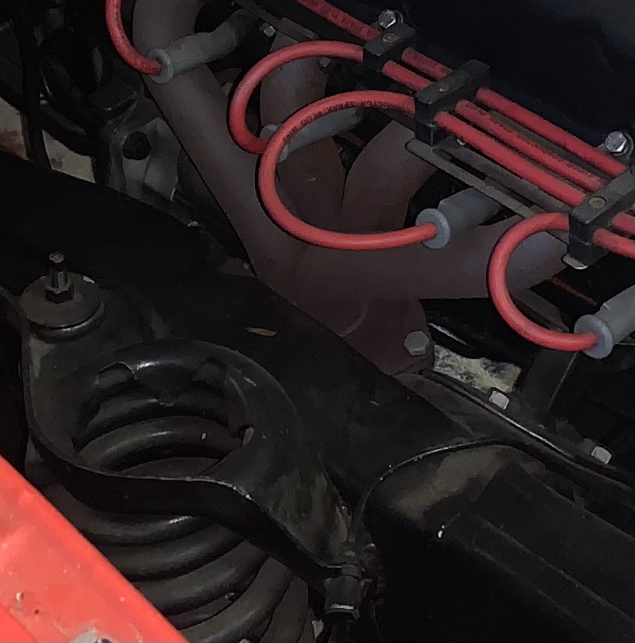

Didn’t have an issue
My whole drive train is centerline
Made my own stuff
