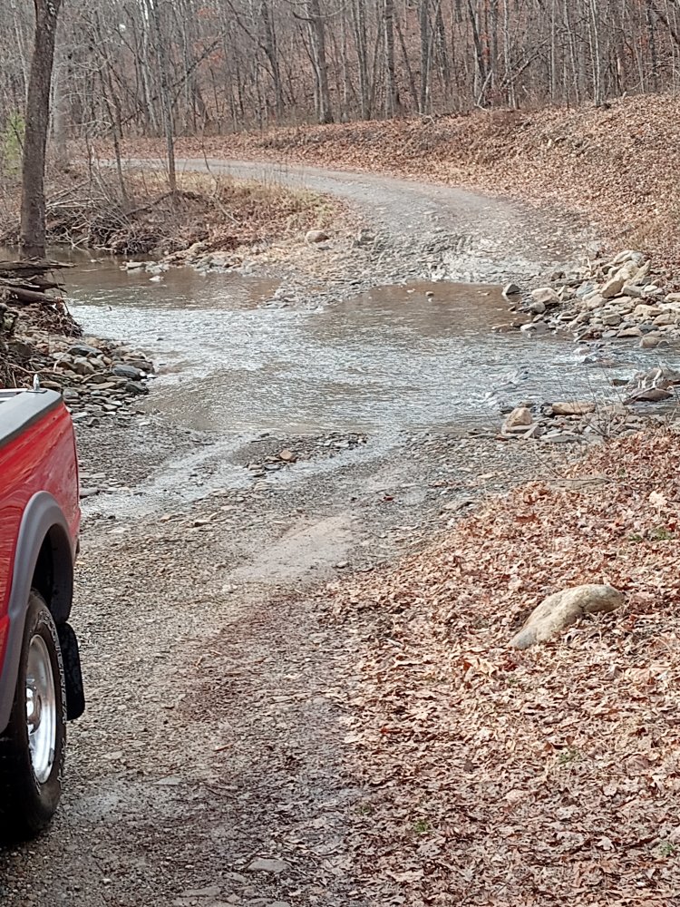

Took pic of this crossing as this was where I stopped with the rwd B3000. I realize it looks like nothing... but trust me you wouldn't want to be half through it in rwd and have your tires start spinning. This was actually the point where I said "I think I need 4x4" last year so finally here we are with one.
Later on the road is more like rough cobblestones and more crossings. I basically coast through the water; to me the harder part was pick where are you going to approach/leave the stream bed. So one like this, very easy, yet, not something you'd probably take your average car through.

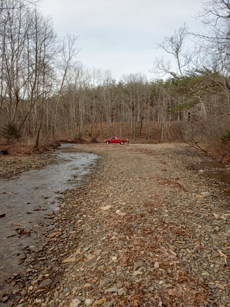

Below, collecting rocks; long view is the stream bed not the road, there's probably a good 70-80 yards there you could do some plinking.

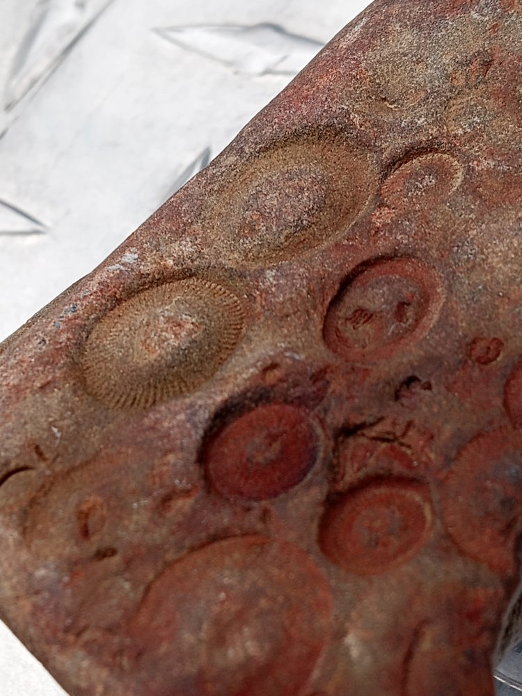

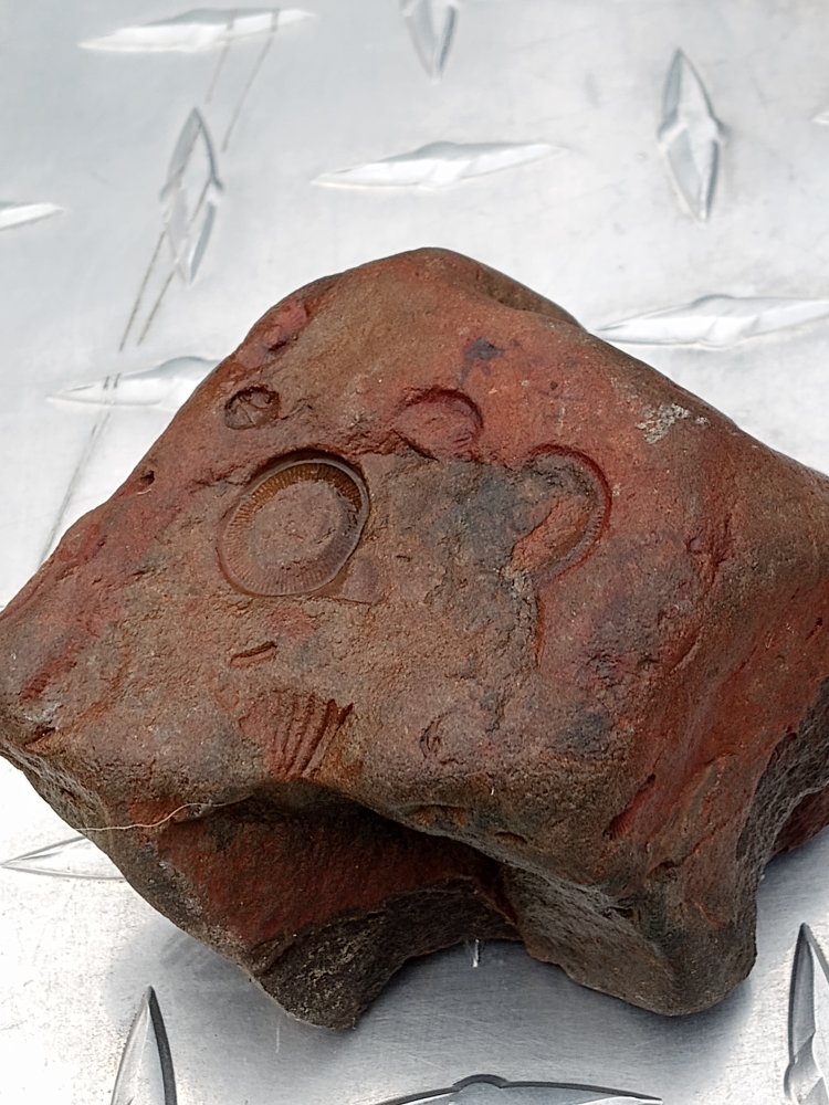

here's fossils but it looks like a brick doesn't it?

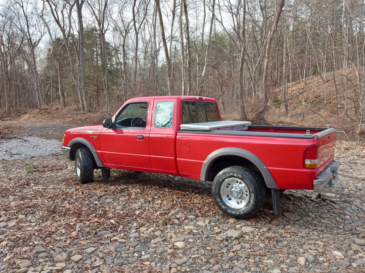

the end it was a good time

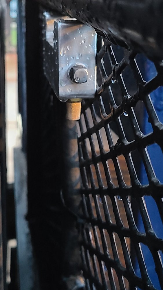

One thing to do ahead of time, if you're going to be hitting deep water, is to extend the breather vent hoses to a higher location. Your transfer case and both axles have vent tubes with a little fitting on the end to keep dirt out but allow air to enter or exit. Get longer pieces of hose and replace those. Get the vented end up as high as you can. If these vents are in good condition, they give the axles an easy place to breathe and minimize the chance of ingesting water when they need to draw air in due to cooling and contracting components. Doesn't help for front wheel bearings, though. You just have to have good seals there.
I recently built a little manifold and installed it on the front of the truck bed between the bed and cab. I ran all 3 hoses to that manifold.
In my recent creek dunking, those vents were still at least 24" above the water level.
