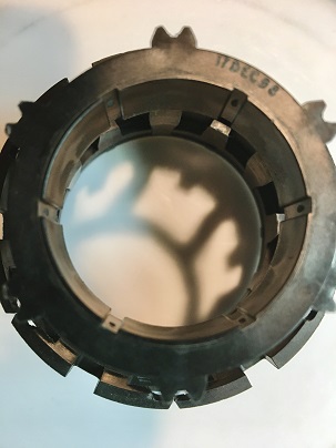

OK, first off, if you have a Biblical/Historical/Allegorical problem with the repetition of the number 6, six, or 6, :eek: SKIP to the next thread cuz this PVH device from FoMoCo is ALL about da SIXes: 6 spokes, 6 guides, 6 notches, 6 grease grooves, 6 pairs of retainer tabs, etc... (perhaps they were fans of the F-106 Delta Dart--aka The Six--but, then again... AREN'T WE ALL!??)
46401
... there, cropped some sixes down to fours, lol... NOTE THE DATE CODE: 17 DEC 98... makes sense as mah baby came off the line in JAN 99, so Ford had a tight "Just In Time" supply chain even then. (OTOH, such date codes are usually much more cryptic than this, and expressed in fewer chars--think of your VIN--but hey, there's room, so just spell it out, lol...)
So this is the main body or "carrier" for the whole assembly. It appears to be a precision molded hunk of glass-filled(?) nylon(?), very strong, very light, < 3 ounces. This part doesn't bear any torque, it just keeps everything aligned, and plays a key role in the engage/DISengage function.
Even before I blasted it with Brake Cleaner, those 6 grooves in the foreground were empty/dry, but since it's the bearing surface for the INNER gear (splined right on the axle/half-shaft), I'm going to assume they are (tiny) grease "reservoirs" and will pack them with the "baby blue" XG-8 wunderlube.
