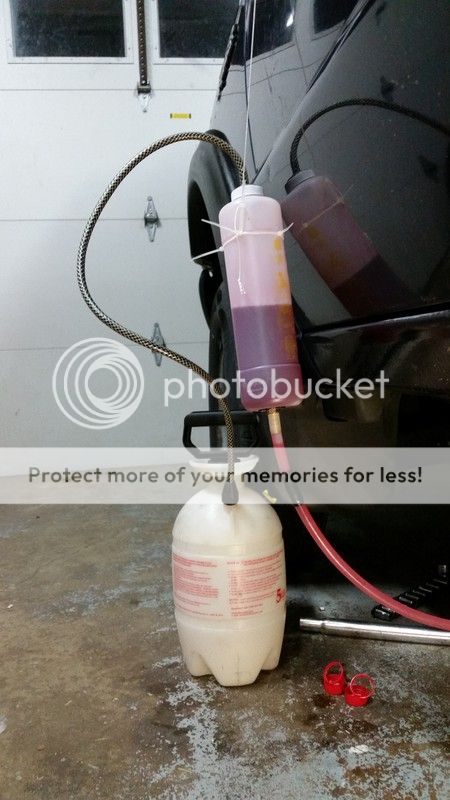

I made a very functional transmission fluid pump the other day and wanted to share a picture. I had many of these components on hand, but can supply some closeup pictures of the fittings if that would help anyone.
Doing it this way kept my pump bottle from getting contaminated with ATF, so I can use it for other things.
My only improvement on this would be to add a shutoff valve towards the hose end at the transmission. The pump bottle has a pressure release which immediately stopped the flow of fluid, but the residual in the line dribbles out if you don't keep the end of the hose elevated. A valve on the end would solve this.

A minor contribution to "the cause"... I probably posted this in the wrong section:
