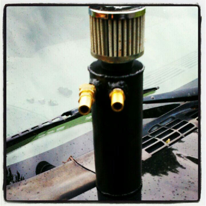

OK...updated it and added new photos...still need a pic of the pot scrubbers I used but that is in the works...
This has improved my oil retention quite a bit. The truck still draws in a bit of oil but that is due to the cheap separator I am using until I can get a good one...but I have to order it from the USA and working on those details (like finding a rich g/f with a CC)...

If you are having problems with blow-by and oil being drawn into the intake then it might be worth your time to fab one up...let me know if you do and how it turns out...the biggest problem I've found is that the can alone does not separate the oil properly...it needs a micro screen (or several) to get the oil to drop out of the air.

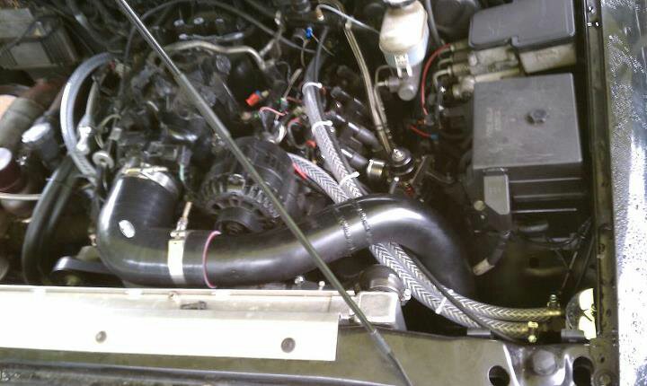

And this is an overview of the way it is set up now.
http://i1179.photobucket.com/albums/x399/akwarian8/Oil Catch Can/AdditionstoCC_zps7c032d90.jpg

I think I finally got it...
Problem was that I had not enough exit lines to handle the pressure. I rerouted everything, put the bigger separator on the intake line and rerouted that behind the engine so it's not as busy around the oil cap.
I'm going to test it tomorrow again on a long, high(er) speed drive to Toronto. Today I went to Beaverton (an hours drive) and was hitting around 80 to 90 Km/hr and only had a minimal amount of tailpipe smoke from oil burning. :yahoo:
I also changed out the PCV and put one from another vehicle on it that allowed me to make the routing a bit more straight...
And last, but not least, I put an actual catch bottle on the bottom of the separator (because it leaks) that could help return oil to the crankcase.
