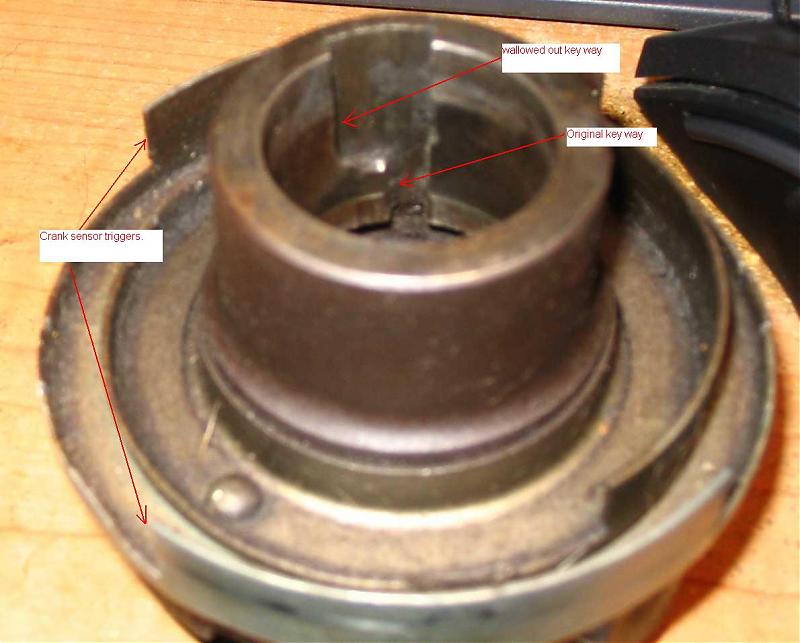

Ok today I finally found out(I think) why the truck runs terrible.Everyone has been telling me it is most likely timing. Well it had a new damper and belt put on year or so ago. Today I was running it and clear as day I can see the crank pulley wobbling.From what i have read that would throw the crank sensor out of wack and make it run exactly how it is. Also from what I was told there is a keyway that holds it on? I havent seen it close so im not sure.Just wondering if anyone would have an idea as to why that would work its way loose.Thanks!
Yes,that is what will hapen when it runs loose.I would get one soon as if it flexes to much,the vanes will hit the crank sensor and snap off the pickup.
The key way is what aligns the hub onto the crank shaft there is a bolt that holds it onto the end of the crank. What happens is that the key way wallows out this allows the hub to move on the crank shaft and throws the timing off. If you look at the photo I attached it will kind of explain what I am talking about.

I had a seized belt adjuster on for the longest time and the belt was really tight before, I replaced it months ago but at the time I never noticed any problems with the crank pully, I guess the damage was already done and just got worse over time.
