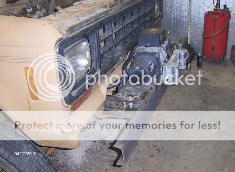

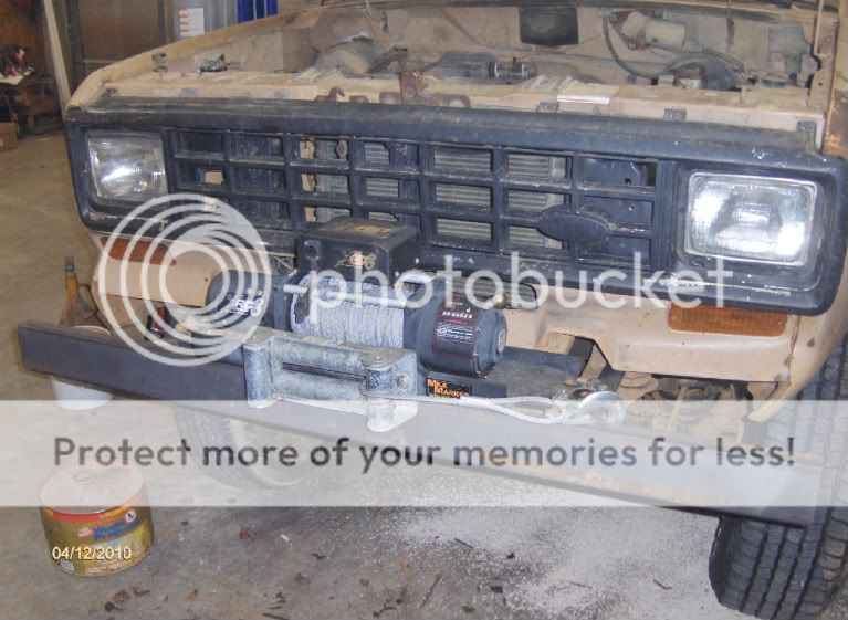

Ok fellers, here's the winch mounted up & it is working awesome. Still have some things to finish up but this is what it will look like when I come up.
Turkey Bay Dec. 11th and 12th....
***********Anybody have any suggestions on where to go from here? I am wanting
each side of the bumper to angle in & meet up with the body, also planning on integrating the brush guard that I had on before????**********

You have just got to be "the free tire guy"!!!
I like that it's simple, no block of airflow.
Cut the front piece of angle at each exterior side of the winch mount. Then weld those pieces onto the angle mount coming out so it runs along the bottom edge of the valance under the turn signals. Weld/bolt whatever brush guard you had to what is there. :icon_idea:

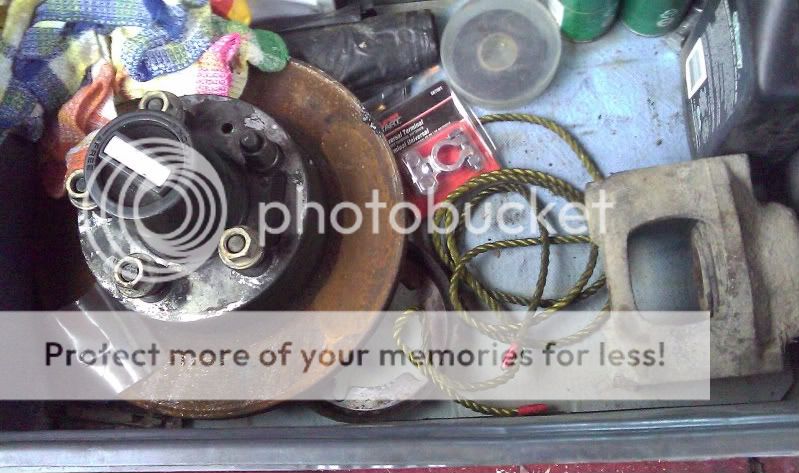

What do I need to bring? Camping? Tent, sleeping bag, cooler.....
I am coming prepared for the trail this time.
Spare caliper, rotor, spindle, bearings, nuts, hub, and both front axles!

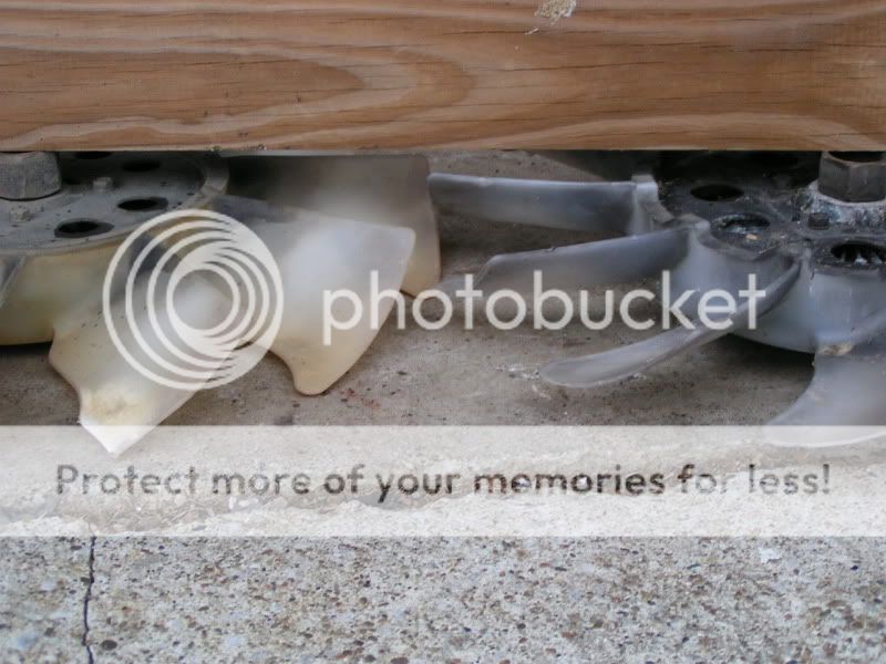

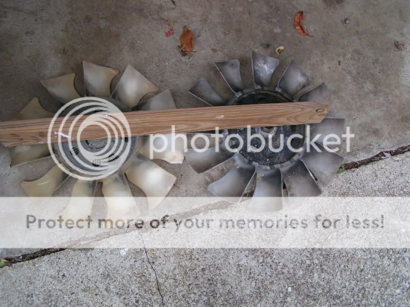

and the culprit.....the fan on the left was from the engine donor ( an Ex ) while the one on the right is from my Hydro-locked motor....
you can see that the Ex fan is sitting on the concrete, while the stocker sits about 1" above the concrete....while the mounting "nut" is at the same height for both....
will be running my extra "thin" radiator til i can get my "thick" one fixed or replaced
