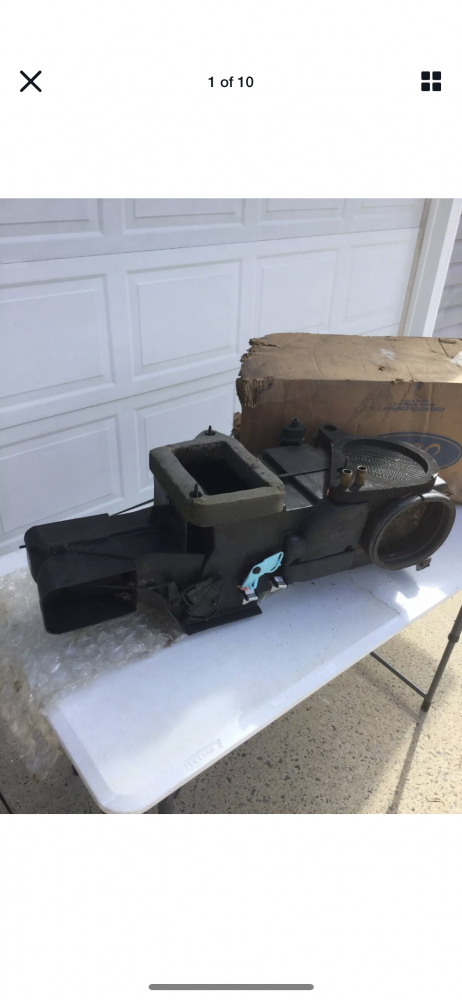

ps: looks like this is what I’m looking for? Does 200 sound a bit exaggerated for an airbox? Sounds like a lot to me..

That does sound expensive. Also, that picture is of the dash side, which I believe is the same between the AC and non AC boxes. You need the engine side of the box as that's where the evaporator is.
Someone will correct me if I'm wrong, but I'm pretty sure you just need the engine side of the box and It'll bolt right up.
I bet you can get the engine side of the box from a wrecking yard for ~$25
