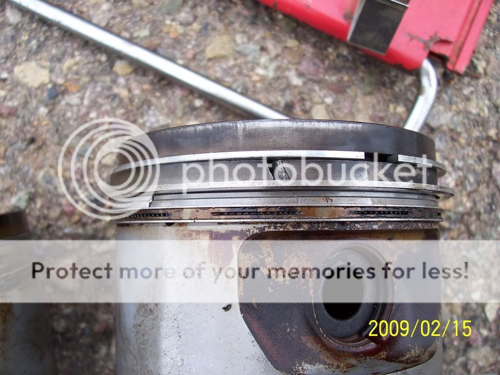

n/a piston+ 15 psi =
iv seen that pic before. i have a turbo'd ranger with n/a pistons on 7-10 psi boost and its my DD and iv never had a problem out of it. i wouldnt go anywere over 10 psi though. Ever.
