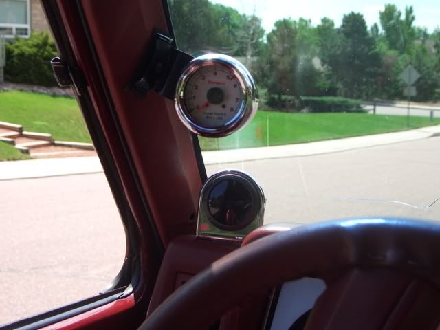

Here is a switch to light up the boost gauge:
Turbo Charged 4.0L BII Build
My gauge set-up. The boost/vac gauge is the smoked black one, Tach is on top:

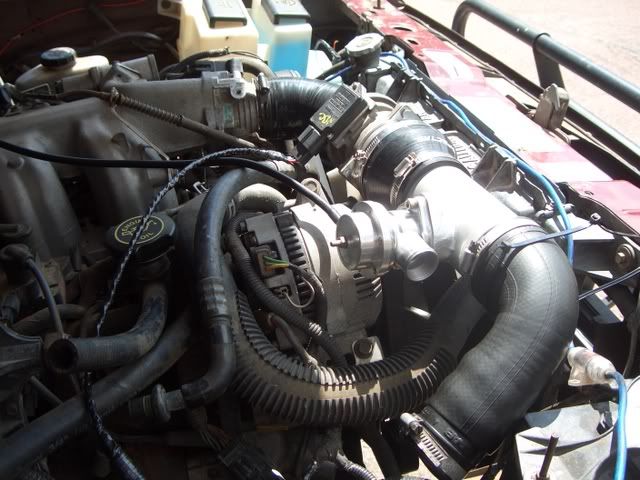

Now for the stuff under the hood!
I had to trim the radiator fan just a tiny bit for the MAF sensor to fit in right
Here is the intake set-up:
I had to extend the MAF sensor wires about a foot for it to reach its new position. Then the Blow Off Valve and then a 90 degree bend down to the turbo
