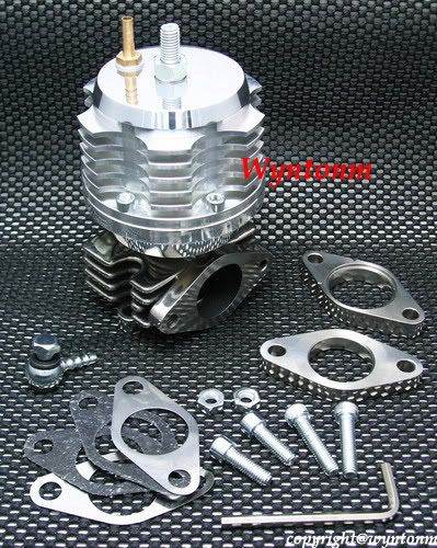

I just got back into town from my band gig. Made enough money to get me my external wastegate to control boost. I will order it tonight.
I have to wait for my BOV and piping to get in. Once that all gets here, It will be one good day of work, welding, and PICTURES! she will be good to go!:icon_hornsup:

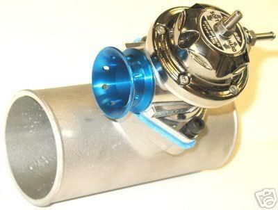

I went and picked up my Blow Off Valve today with a silicon coupler:

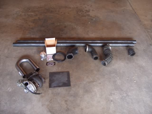

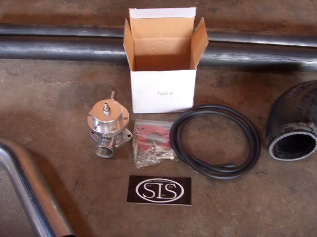

Here is all I have as of right now:

Today I made stencils of the flanges I need to make and wired up my boost gauge. I am waiting for the external wastegate to get here and the Blow Off Valve aluminum coupler.:icon_twisted:

Well one of my Parts came in today:
Just the aluminum pipe. The blow off valve is show

External Wastegate

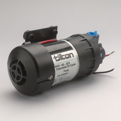

AND Last, but most important is my scavenge pump
