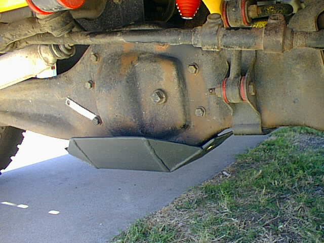

I had one that bolted to the front of the beam through the lower bolt holes for the pig and wrapped underneath and all the way up to and was supported by the pinion snout.
Huh? How is it they are useless junk? Mine's served me quite well...
Or like yours

Don't make one like this. It sticks out too far and will rip the bolts right outta their mounting spots due to a good hit on a rock, then you will have a bent beam. Get one made like Sasquatchs and Junkies that mounts flush with the face of the beam and then wraps around the snout of the D35
Yours looks reasonable. I'm thinking more along the lines of the full length skid plates, always thought they'd get hung up on stuff more than prevent damage.
