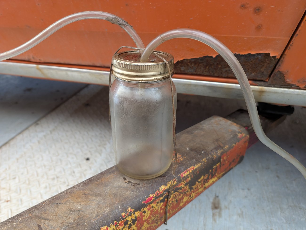

There's another way to bleed brakes that doesn't require any special tools to do solo. Just run a hose from the bleeder nipple into a jar with clean brake fluid in the bottom - so that the end of the hose is always submerged. Then, crack the bleeder and pump the brakes yourself. All you need to do is make sure the master cylinder doesn't run dry.
When you pump the pedal it will push out whatever's in the lines, when you lift it'll just suck fluid back in. This does require having bleeders that fit properly - if the threads are loose, air will get in. Not usually a problem. This is how I do mine when I don't have a helper.
Does this method risk moving the bubbles back and forth somewhere in the line before the air is expelled??
No - assuming the bleeders don't leak air around the threads (shouldn't happen) the biggest risk is pumping all the fluid out of the master cylinder. It goes down fast so you need to keep an eye on that.
Although you can't really pump the pedal while watching the jar/container, I find if you're in a quiet environment you can hear bubbles escaping and sometimes your can even feel them in the pedal.
Not back and forth. Just one way.. But if there are bubbles there, you WANT them to move. They should be pushed down the line and out whichever bleeder you have open.

With the method I suggested, really all you need is a piece of tubing and a couple bottles of fluid just in case. And an empty coke bottle or jar or whatever. Good luck!
