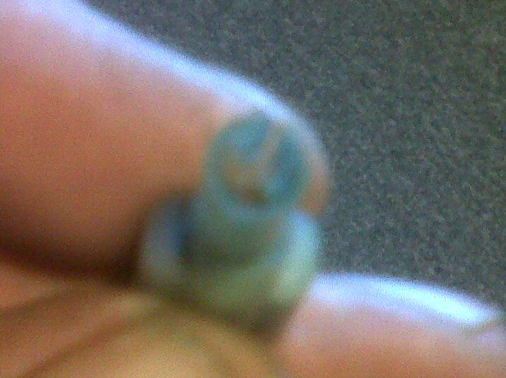

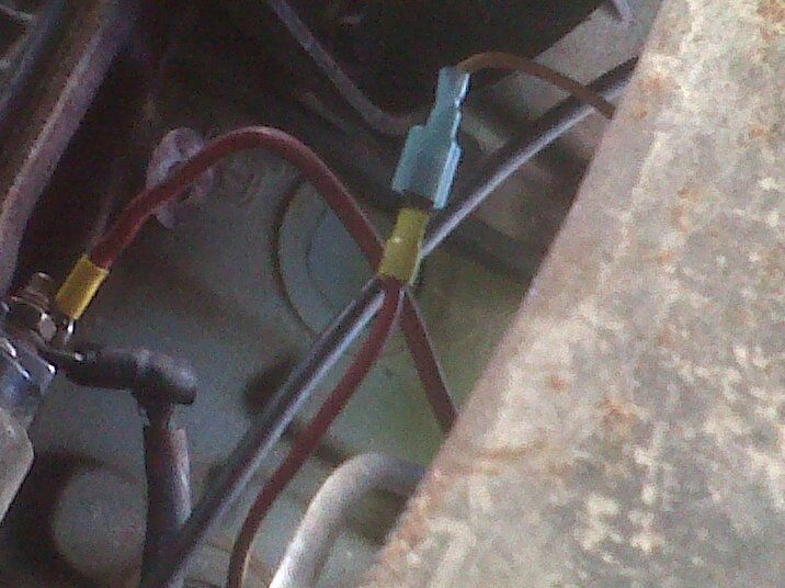

After that the starter would not engage...tried jumping at the solenoid and same thing...good battery power...so when I went to remove the starter I got one bolt out and the wires disconnected when I saw the "frayed" wire...I traced it back and it was in bundled with the ground from the solenoid (or wherever)...the connector was held on by one wire and the connection was corroded...so I pulled it off...thought I had one to replace but had to take a short trip to town...got that connected and tried the starter...WINNER~
I only got pics of the new connector as it shows up under the truck...and the one that I took off...
So it wasn't the starter at all...just a wonky wire...oh, and it was a 4.0...very nice little truck with a 4.5" lift and some nice tires...

Sorry, the last two images are blurry...but you can make out the corrosion and the lack of wires...
