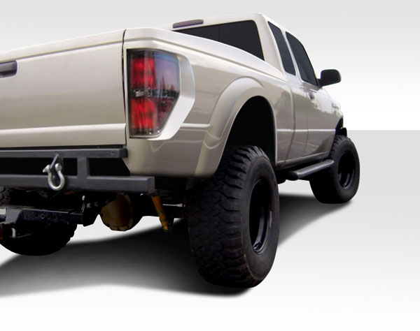

I really want these bedsides, but I can't find them narrower than a 5-inch bulge. I'd have to run a full width 8.8 to fill them in, and then they'd probably look funny unless I widened the front.

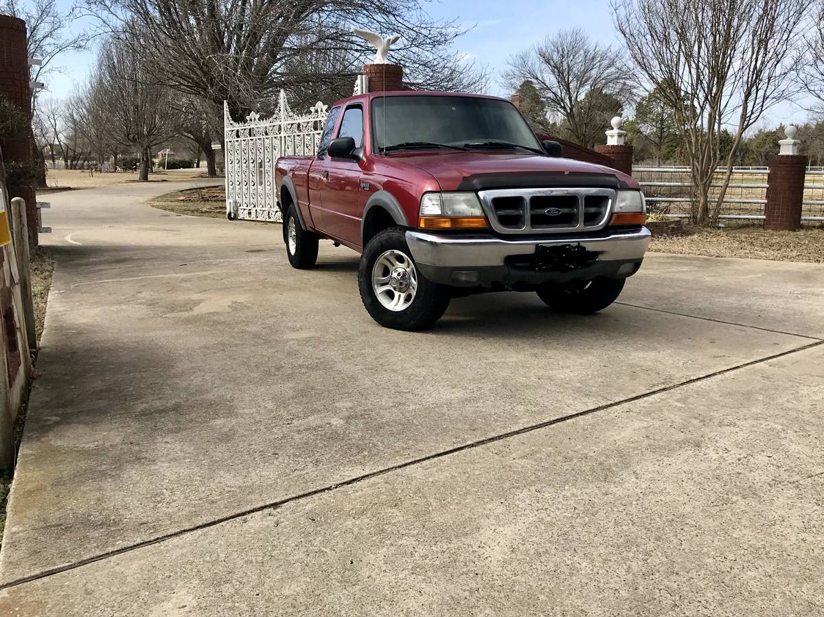

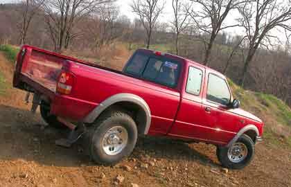

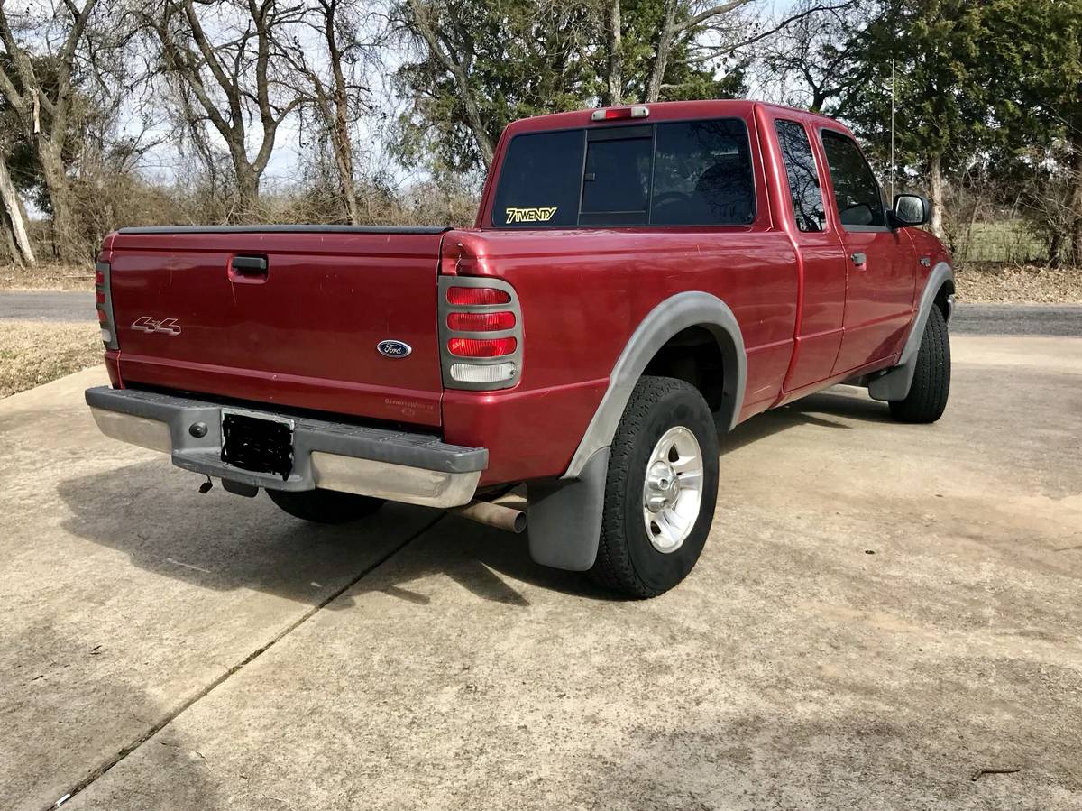

I found this 4-door Ranger 4x4 for sale locally. It reminds me of TRS-2 (the two small photos), my 1996 Ranger 4x4 when I first got it.

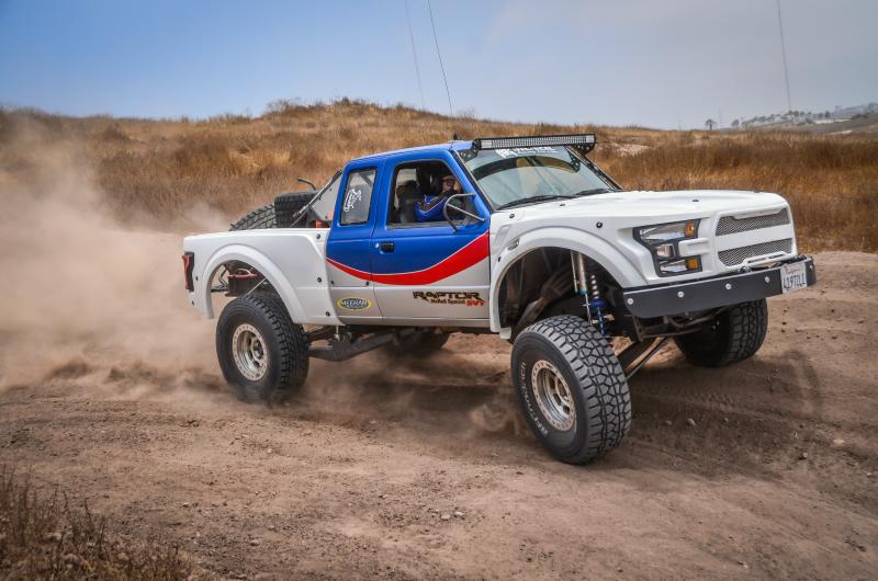

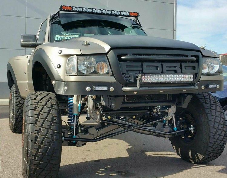

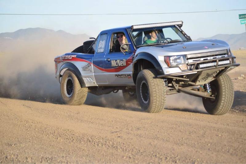

Then there's the Ford Ranger Raptor Options.

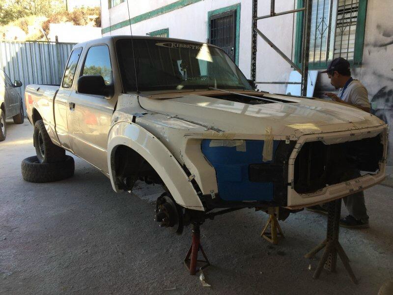

I don't care for the 1-piece front clip design. In the last photo, you can see where someone is converting a Ranger to a Raptor, but with separate fenders and a hood that will open. I have not found any more photos or info on that build.
It looks like a nice truck, bummer the bug shield is broken though :bawling:
