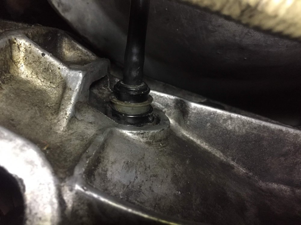

I can't tell whether or not I need to remove the clip from the receiving end on the slave cylinder to remove the line. In one video above, he does remove it. In others, they say not to. How do I know? M5R1 5 speed transmission.
Edit: He says not to remove it when INSERTING the line. So I guess I need to remove it? Someone must have changed the slave cylinder in the past. Unfortunately, the transmission housing is in the way of the clip. Should I grind it back?
