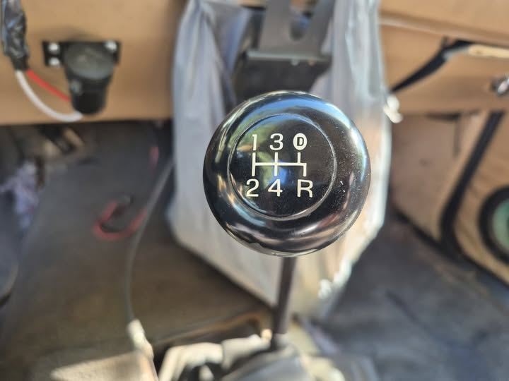

HI,
Ok so what do you call this and is why I say 4 speed with OD.. So how do I know if a 5th gear (marked 1 - 5) and OD (1-4 w/OD) are the same ratio.

The circle with the D means Overdrive. So it's a higher ratio than 1 to 1. If the handle is marked 1 to 4 with OD then 4th is 1 to 1. If the handle is marked 1 to 5 then 5th is 1 to 1.
Yes, it is technically a 4 speed with overdrive but everyone calls them 5 speeds... it really is semantics but this is the internet so you'll get that :)

HI,
I see what you are talking about, and you are not wrong. We are just trying to help you find parts for your truck. I think if you do any type of search for your truck, and call it a "5 speed" I think you will get better search results calling it that.

I don't think Ford made a shift knob with a 5th gear marked that had less than 6 gears, they're all that OD marking. Although I haven't seen a knob for a ZF6 since it has two overdrives... there's 5 gears so people call them 5 speeds... way simpler, with that shifter knob you get things like one of those "customer states" videos I saw a while ago of a mechanic whos customer complained that their Ranger engine stalled when put in drive, they were referring to the OD but since manual transmissions aren't common anymore someone somehow thought that was just the auto option or something?
All of the ZF6 transmissions I'm familiar with are still single OD units.
For the trucks it's one low pulling gear, 4 regular gears, and one OD gear. No "5" marking on those either. R,L,1,2,3,4,OD
It was also used in some foreign built cars with different gear ratios. Those didn't have a a pulling gear like the trucks, but still a pretty low first gear. Still no double OD, the 5th gear was 1:1 and 6th was OD. Not sure how all of those were marked, but a quick persual of pictures from the respective cars, shows the pattern marked R and 1-6. Also a different shift pattern than the truck transmissions.
As y'all have been trying to explain to OP it's called a 6 speed due to 6 forward gears, regardless of the fact that one of those is overdrive and another isn't meant for normal driving. Been that way for decades. The NP435 in my '68 is called a 4 speed, even though first is a granny gear not meant for normal driving. Really wish it was a 5 speed for an OD ratio, and that swap may happen eventually.

Hi,
Semantics aside, the shift lever pictured in this thread is that of a TK5 which is a 5-speed transmission. So what you're looking for is the transmission described as a 5-speed. Sometimes they also get described by the shape and bolt pattern of their pan, which helps avoid mixing them up with the FM transmissions.
That aside, if your shifter is super sloppy, the transmission is in all likelihood actually fine and the slop is in the shifter. This has been a much-discussed problem in the past, well before I got into Rangers. There is, or was a company that sells a replacement TK5 shifter because of how common this issue is. I am not immediately aware of its availability today.
What I did with my TK5, which behaved extremely badly when I got the truck, was put on the shifter from a TK4. The pivot ball assembly is all metal on those, vs all plastic on the 5, and it is way, way tighter. People have described needing to modify it to get proper engagement on certain gears but I did not modify mine, just bolted it on and immediately felt like I had a brand new transmission underneath me.
I would strongly recommend you pursue the same option before trying to swap the trans itself. Be warned that the shifter may be unique to RWD vs 4x4, I never got clarity on this.
