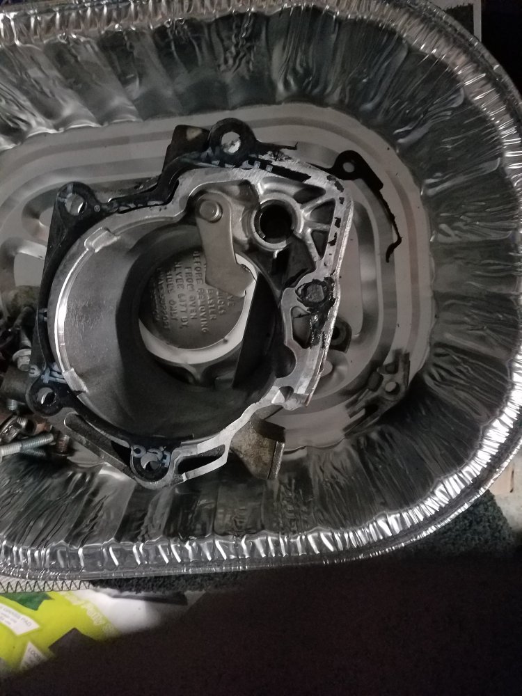

I went ahead and took the transfer case and extension housing off and this is what I found. The first picture is from the transmission and if you notice, there is a missing piece where the pawl's stud should go. The parking pawl went out a while ago and I guess we know now why.

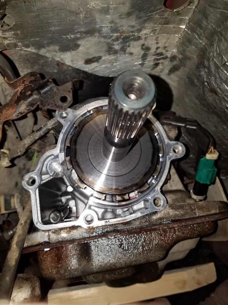

The second picture is of the extension housing. You can see where the gasket just disappeared. I doubt it was where the pawl's piece broke off and wore it out. The bottom right is where the housing broke off when removing it. I was hitting it with a 2lb hammer to help dislodge it on the bottom left and the bottom right broke off. I thought it was stuck but I was wrong. The upper left stud that had two nuts on it - one to hold the housing and the other was holding a bracket. I took the first nut off and thought that was it but I was wrong. Anyways, the gasket was ripped apart and that is where I saw the leak. Have to go to a salvage yard now to see if I can find a new extension housing.
Glad you figured it out! Hate you busted it to find out what it was leaking!
